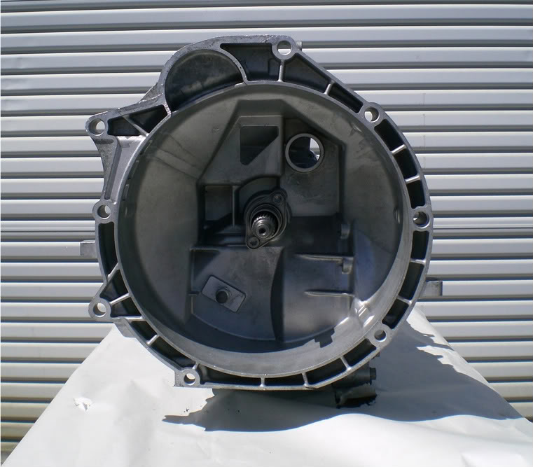

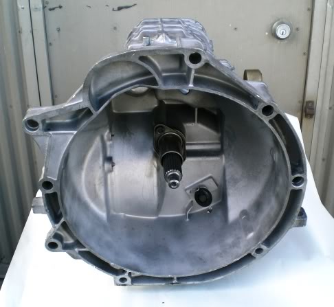

I'm still questioning the ls1 to 901 bellhousing adapter, clutch stuff, and throttle linkage..........
Are there other companies that make these parts? What did you do for those?
I appreciate any guidance, as single income with 2 kids and wife the less I spend the better, without cutting corners. If there is a good way without the renegade hybrids kit, then I will be all for it even if it requires a little more work.
