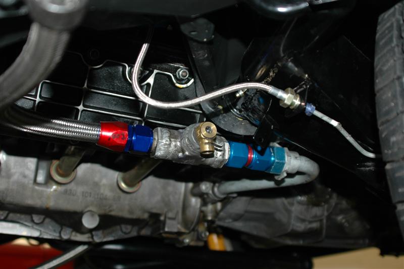

Bill....The factory part number for the drain valve is F-109. PP must not want to stock it. I've used one on my work truck and pickup for years and have had no problems. I have one on my six on the tank/cooler hose. I put it in there to keep from having to undo a hose connection to drain tank and cooler for a oil change. Clearance would be a question on a four. It adds about an inch to the bottom of the engine case. You would have to bottom out pretty bad to knock it off. As I'm not running a four, I'm not sure what clearance problems there would be on a four....

I definitely would not want one hanging low on my -6. But I have always wanted one for the oil tank. That hose set-up looks great!

I used an aluminum "T" and welded on AN fittings. On the third outlet I welded a plate and tapped it to the size of the drain valve. I used JB weld since the valve was copper. I loosen the hose ends and turn the valve down to drain. The way it is in the pic it is turned to the side and there are no clearance problems.
