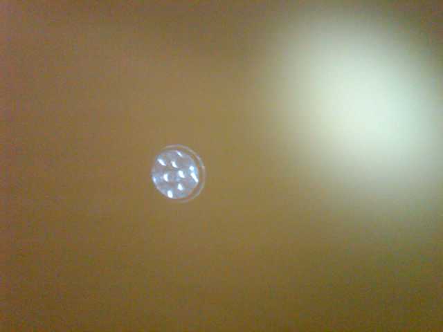

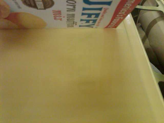

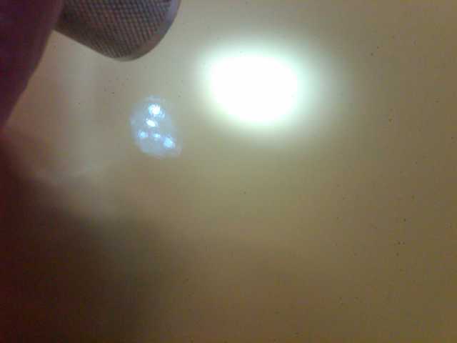

OK did some tests,,, I tried the lacquer thinner on the engine hatch since it had came out the worst, some how I missed some debris and when I sprayed the targa bar from underneath it blew a couple of chunks on the lid... The new paint did come off but not without a fight, it was a gooey sticky mess,,, as a alternative I wet sanded and did a quick buff on the top of the targa bar.. and the paper didnt really clog up too much just a bit, and it did seem to buff out decent but all I had on hand was some foam pad polishing glaze , and it came out real decent considering it wasn't a cutting compound... and it didnt seem to gum up.. the paint doesnt seem sticky,, if I press firmly with a fingernail it doesn't leave a mark, but if I press as hard as I can I can leave a mark.... when I was getting the paint the salesperson said that some guys will use hardener in the last coat, but suggested I didnt because it was alot easier to run and since I had not shot some paint in a while that is why they steered me away from the hardener, but is was suggested by someone earlier that if I hse hardener on a later or last coat it will cause problems... Again they said most of the guys that are using the centari don't use hardener... do they not have a clue? or is it ok? So What to do?????????? I shot this last night,,, today is Christmas eve, tomorrow is Christmas day, So no stores will be open,, Can I wat till Saturday to "lacquer strip the paint"I'm sure I dont have enough lacquer to strip the whole car ,NOT to mention it will be a mega heartbreak doing all that, Is it absolutely necessary? or can I wet sand the orange peel out and try again MAYBE using a hardener,,, or wet sand and go urethane /base coat clear coat, I think urethane can go over about anything, but can someone confirm this and would I have any problems having this "unhardened added" paint under it?... Man I feel like a idiot its been too long since I shot some paint ,here are some shots of my problems.
targa bar quick sanded and quick foam pad buff this shows a bit of reflection it hard to photo
light shown on sanded buffed targa bar
light shown on Unsanded trunk panel showing dry paint the led in the light look blurry
