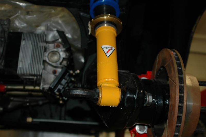

I have the BIG car tie down ratchet straps too. I bought the "axle" straps and run the strap throught the front suspension lower arm and loop it back to the "D" ring on the strap. Depending on how much strap you have maybe you can do the same and attach both ends at the tie down ring. On the rear I bought two big eyebolts and cut off the threaded part and welded the ring on the shock bolt. I clip one end of the strap to that and the other to the tie down ring...
