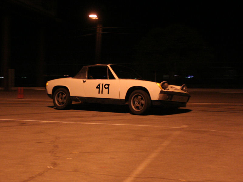

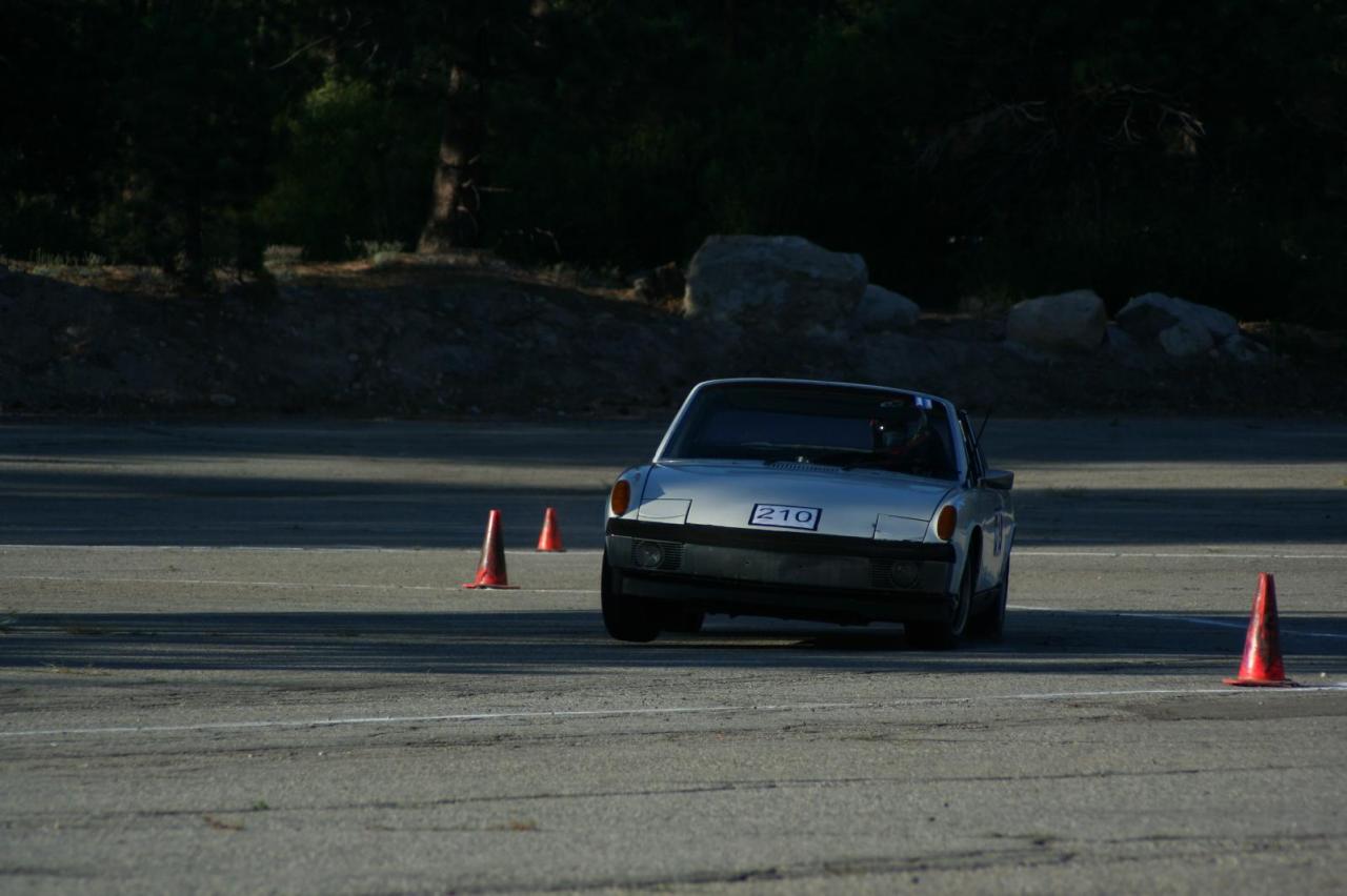

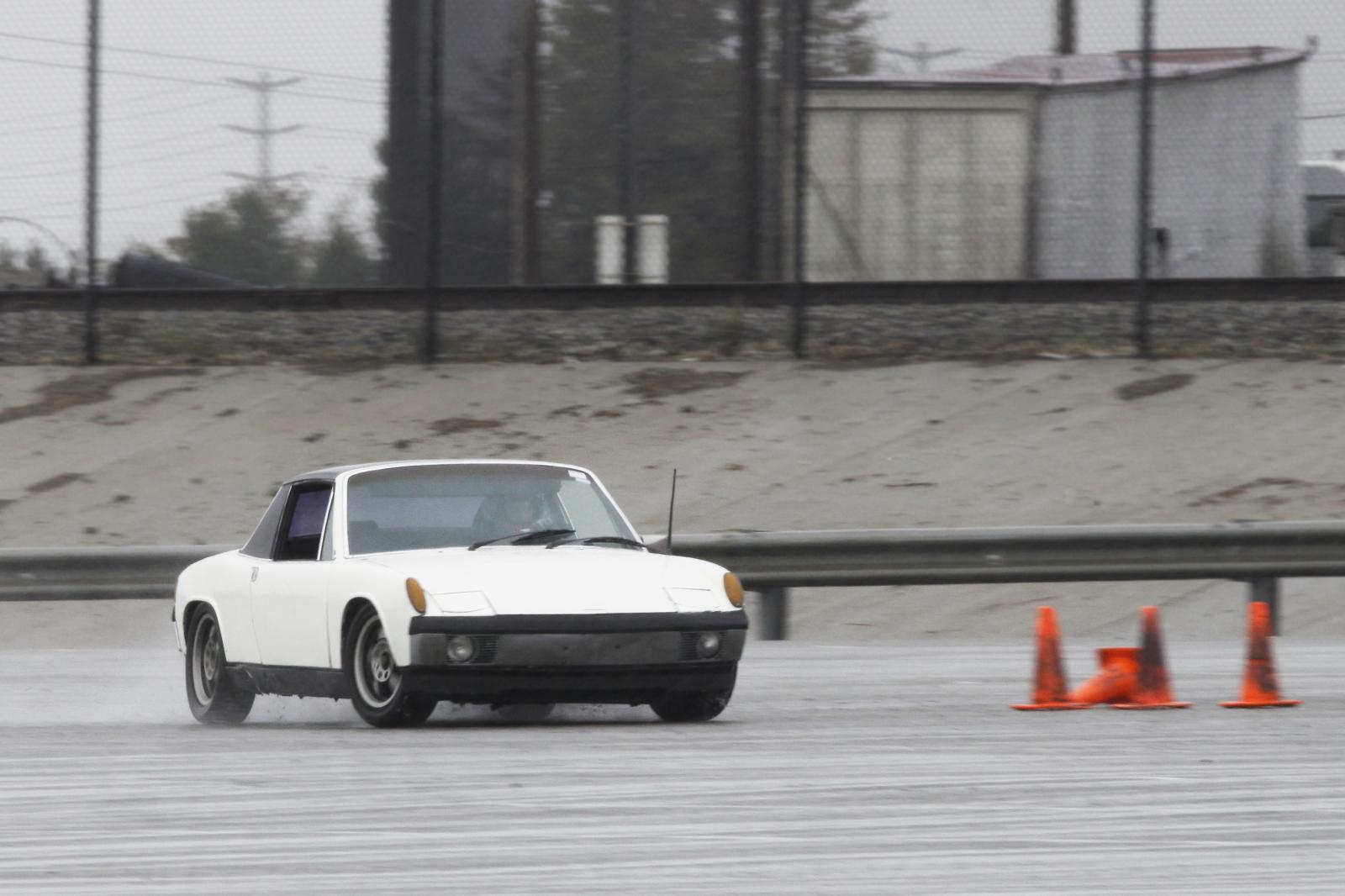

Original:
Front swaybar ONLY, and stock rear springs
Front bar, 200 lb springs in the rear, and Konis on all fours.
If you mount both front and rear bars with stock springs, you balance should be close, your ride shouldn't be too rough, and body roll will be minimal. My $.02 Enjoy the disease! driving.gif
