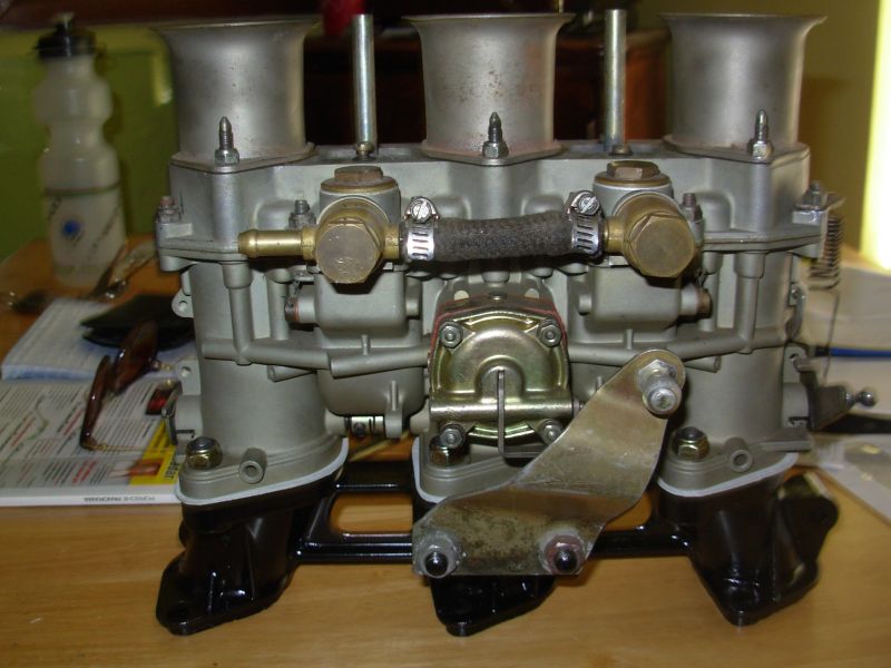

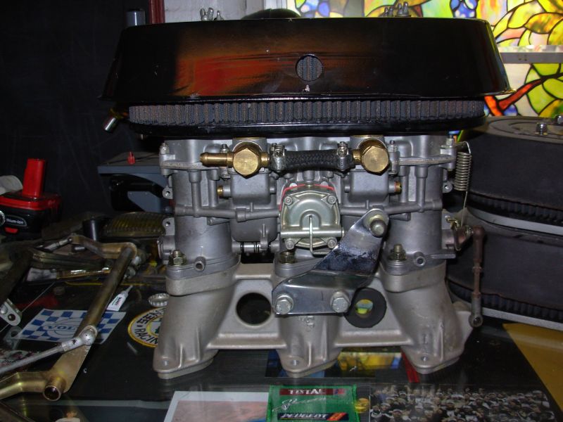

I just sold a set a month ago, I don't have any more. You can also get the tall ones from PMO - They look better
vs

My 76 was 35mm which I opened to 36. According to the book, all the USA 2.7Ls were 35 mm intake ports. The exceptions were the "normals"(150 hp) and the RS (NA in the USA) at 36mm. The "short" manifolds (the black ones in TCs pic) can be opened to 35-36. The "tall" (PMO) are 36mm from the get go, IIRC.
The PMO insulators are 36 and (IMO)you want these and the manifolds as they block off the notch in the head as cast for the injector.

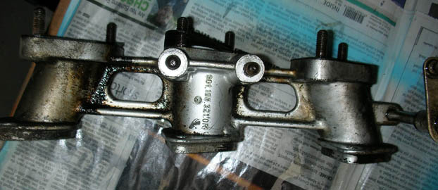

My part number is 901.108.321.OR it was from an early S on my 2.5 69S
The size is 41mm over 38mm on a low dollar bullet loading plastic gauge.
I had early 69 ported S Heads that I sold to Mark and I am going to be running fresh 76 S heads.
