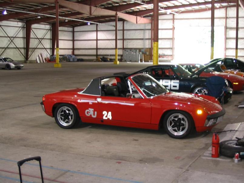

50's on my racecar, 60's on my street car. I'm buying new street tires soon, I'll put 60's on again. They're just right.

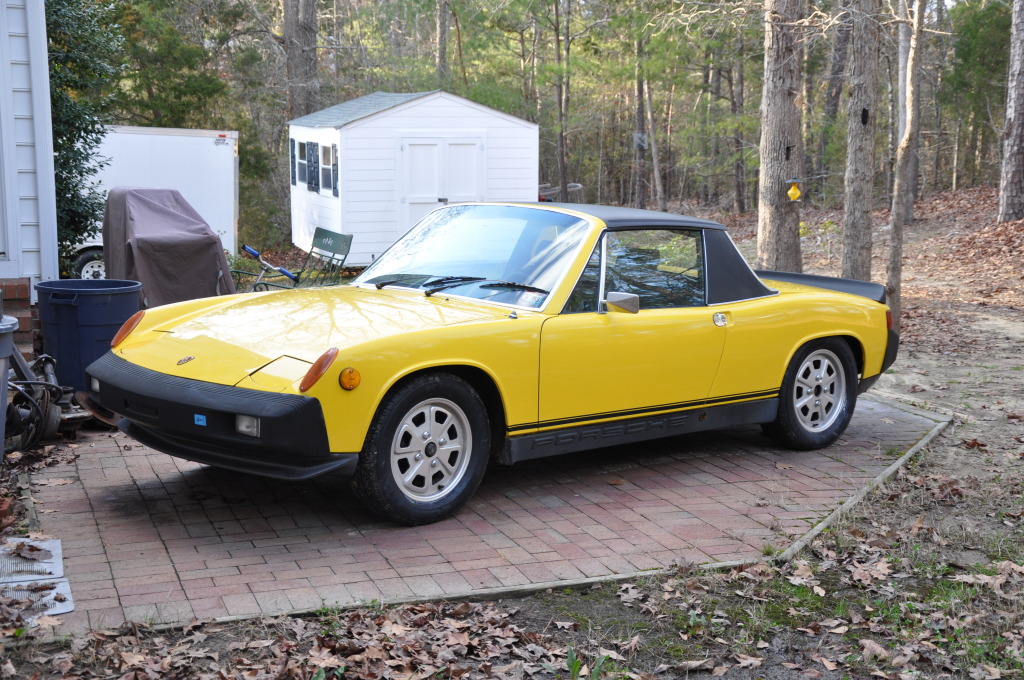

ttwitc9516
Mar 25 2010, 07:13 AM
Real easy formula to figure tire diameter is A*.B*2*.0394+C
A=width in mm
B=profile ex, 60 or 50
C=rim size
example 215*.6*2*.0394+15
use this formula in a google search bar and it gives overall diameter
btw-this is what I'm running and have had good luck. Had to roll the rear fenders up but that was the only problem.
