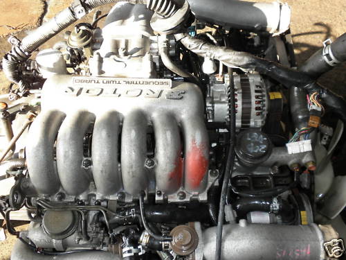

Mazda 20B Wankel
Sequential twin turbo
280 HP @ 6500 rpm
287 ft lbs of torque
Not a cheap engine $4000 used JDM, but cheaper than Subie STI, Porsche 6 and others
Thinking about removing the V8 and re-geared tranny and going with this setup.
Any thoughts? Anyone need a V8 setup?

Great engine, as long as you keep up on the maintenance and NEVER run synthetic. There are a ton of parts for them and they don't make a lot of torque off idle, so the transmission does not take a ton of abuse. Been thinking of doing the same swap myself. There are adapters out there for the bellhousing because rotarys bolted to VW transaxles is a common sandrail setup.
Funny thing is, though, that everybody with RX-7's seems to be taking out the rotary and dropping in a V-8. You should be able to get a decent engine without needing to go the JDM route.

The 13B TT is common and cheap but they are only 2 rotors. The 20B is not so common and it's 3 rotors. For the $4K I can get the whole front clip through JDM. I think this would be like getting a car and stripping it. I like this idea. I could get all the parts I need from it and not miss something.

Atkins rotary can set up however many rotors you want....
$$$$$ is all it takes when you talk to that guy, but he is the best in the biz.

I have installed 3 rotor and bridgeport 13B units in Lotus Super 7s. Racing Beat can supply intakes for side draft carbs and basic kits to fabricate headers. The major concerns Ive had arre the depth of the oil pan, the extreme heat generated, and the exhaust noise (music?) level. You can be sure with such a short area to place the exhaust it will spit flame w00t.gif On the plus side for autoX you only need one gear as it will rev well into tomorrow....

I had a 13B in my 63 VW Double Door Chop Top Panel Bus. It was wicked fast! It had an unearthly howl from the exhaust. I don't mind the noise. I never had any issues with heat or lack of oil. I beat the crap out of that engine. Too bad I never upgraded the brakes!
I like the power to weight from the rotary and the high revs. I'm not sure what the 20B weighs but my cast iron V8 is about 800 pounds.

Friend here in Houston did the same, switched out a streetported 13B (Racing Beat manifold, sidedraft 48 Weber) for a 350 Chevy. Same reasons, heat (with a Renegade radiator even) and noise. It sure was fast though, and very light.

Top Super Street Modified Autocrosser runs a 20B in is FD Mazda. Absolutely the stupidest fastest car I've ever seen. Nieghborhood of 500HP. Yep Bridgeported 13b pieces. and a single HUGE turbo.
