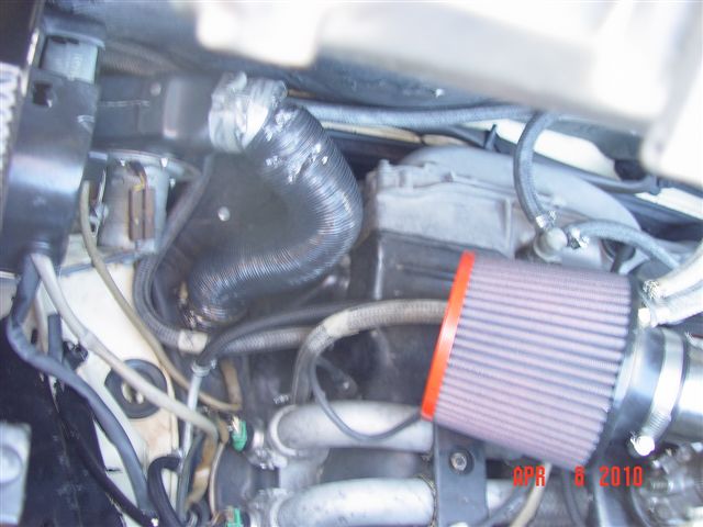

Found one online that looked nice but the pic of the engine looks like it has a single carb. That's a no no right?

QUOTE(Cambo @ Apr 21 2010, 09:45 AM) *
It will get you around but won't make you happy. I wouldn't say the car is a POS just because of the carb. Duals don't cost that much and are easy to install. You can also find all of the FI parts on this board.

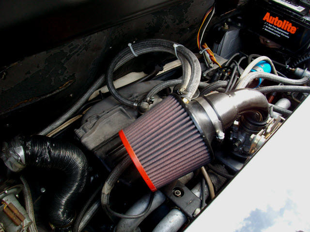

Here's a pic of the one I'm looking at. Single carb right?

QUOTE(Cambo @ Apr 21 2010, 10:08 AM) *
That looks like FI to me. See the green injectors on the intake manifold at the head.
Jeffs9146
And that motor looks well maintained!

Here's one more. It's a 73 2.0
Single carb right?
Nope, that's FI. You can see the green injectors at the end of the intake runners.
Your main focus should be on RUST. They all have RUST. If the owner is trying to tell you it's rust free he either hasn't found it yet or he's trying to hide it.
