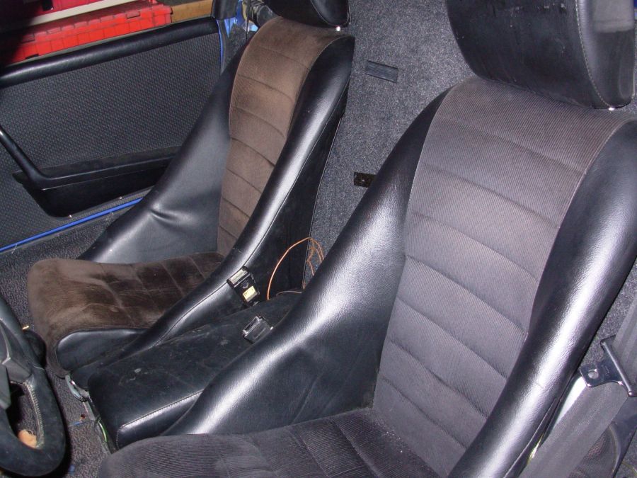

no matter what, the car is on the narrow side, and there is not much room for wider seats,especially if u r tall.
I just put in porsche 911/993 seats from LA dismantlers-salvage co.) in mine but had to do some modification to the driver's side transverse support to lower the seat, as the are longer and wider. Much more comfortable(I'm 6'2", 190- 32"waist).
multiple choice
A: P90x works - lol-2.gif
B: GTS very nice
C: other porsche seats-993,996's (electric too!)(see the attached photo)
anyway good luck- I went with the 993 seats I wanted wider and higher support, much safer, and the seats were much less than recovering old ones and Iwanted leather. any questions let me know.
Phil
