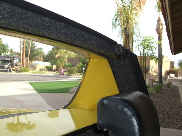

Here is mine covered in perlon. I love the look compared to the backpad.

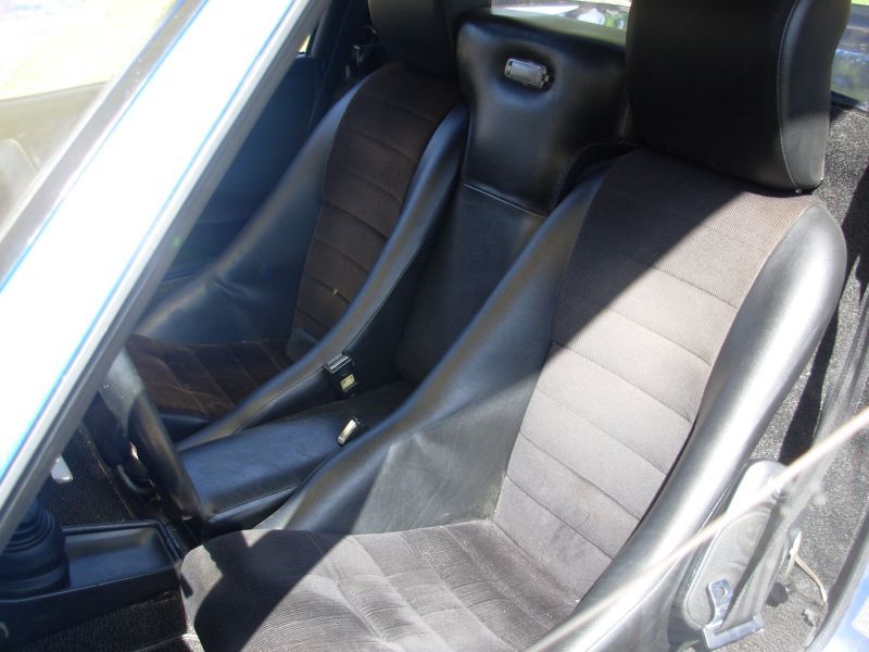

mine...

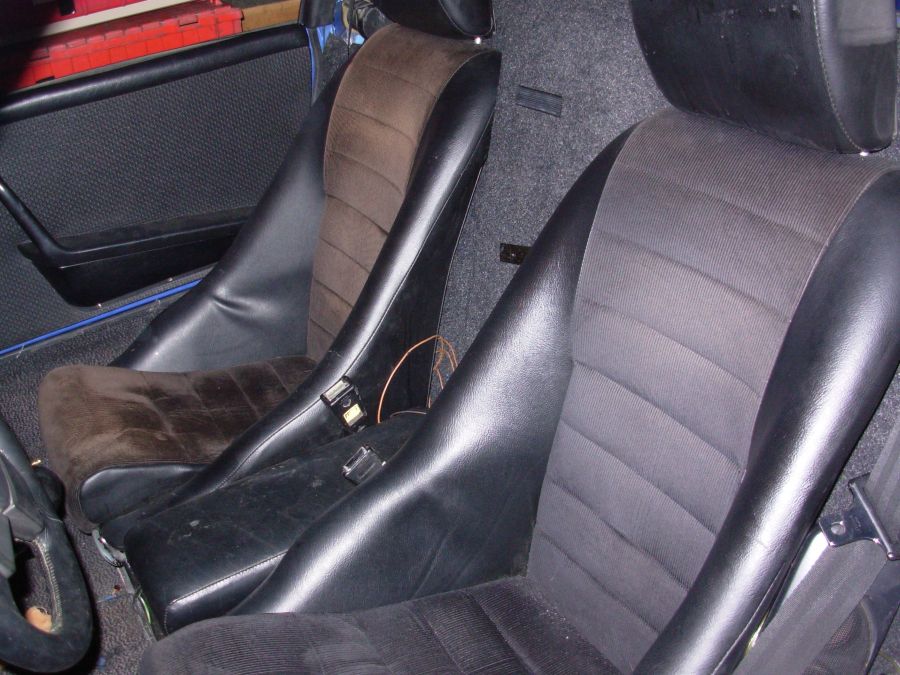

Here's mine that I did a few years ago.

What seats are those? they look comfy and like they'll hold you in well...

Here's mine I did a couple of years back.
Pretty much the same as everyone else. I painted the contact cement on with a brush, and then formed the Perlon on.
Ron

Scott,
Can you tell us a little about those seats? Custom made with bolsters, or a purchased seat?
