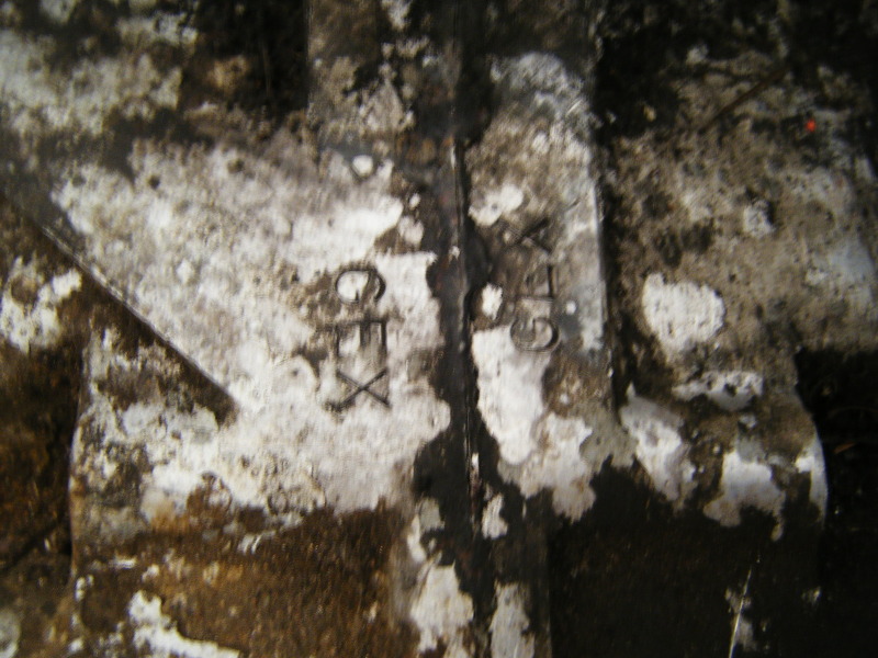

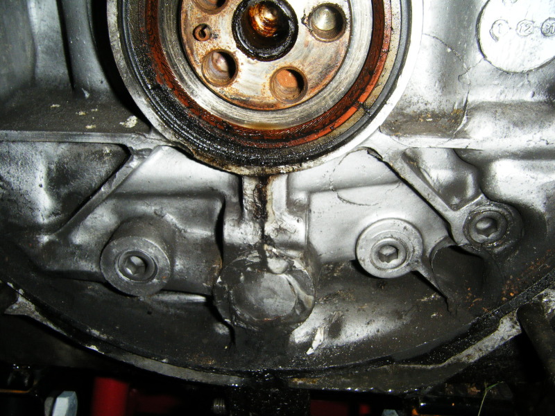

The engine I pulld out of my 1970 car had been sitting in the corner for a while, and I decided to take it apart, get the parts that are good (it did run but sounded like it had a knock) and build up a good engine. I discovered that there is no serial # on top of the case, it is stamped GEX. It already has threaded oil galley plugs, also.

10919 or 10920 are rebuilt GEX 1.8 engines. $1,999.00 each. Mine came out of a 1970 and has the brather tubes pinched off, guess it is a 10919.
Heard many bad things about GEX, though. Anybody have any experience with them?
