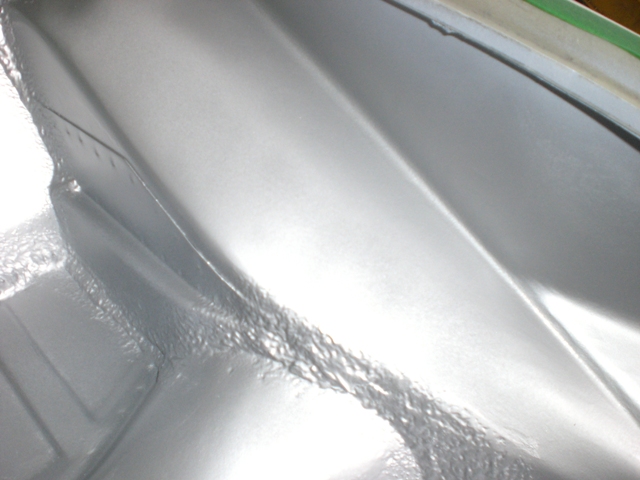

Here is a close up of my inner rear fender. I decided not to clear the trunks, but think this came out pretty well.
rsrguy3
Did you shoot a single in the trunks? If not, you'll be sorry if you don't clear it, just won't hold up to the abuse.
jeffdon
QUOTE(rsrguy3 @ May 20 2010, 10:42 AM) *
No just two coats of base. Hmmm. Maybe i should clear it just for the practice of shooting clear.

Funny, I like what that kid said. FYI, if you want high end PPG at a lower cost, look for a Matrix supplier, You'll get a better choice on clears as well. Also, Before you clear the trunks and engine bay, scuff it with a gray scotch bright, and lay down an even, thin coat of base again. If you don't the clear wont stick, you only have about a 24 hour window for a chemical grip between base and clear.
