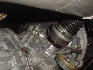

Today I lined up with a 350Z; I let the clutch go at 2K, good launch, and shake, shake, bang, grind, and grind. Axle adapter breaks, shears the starter from the Trans, and proceeds to lodge itself on the shift linkage, and leaving me with my pride back at the light, and my car stalled in the 3rd lane from the right on PCH, with no gears available... Considering that the power for the entire fuse box goes to the starter, and that it fell off,I am lucky I didnt fry any wiring and/or watch my car burst into flames.
Good day, Shot to
Now looking at this I am learning a valuable lesson, that it is valuable to undo your CV and retightening the Axle adapter after 2k miles, and how can I make sure this never happens again...? I know someone thought of this, but has any one welded the adapter to the Trans axle snub? Just a thought....
BTW: I only make 216hp/ 276 ft-lb at the wheel...and am using the renegade hybrids axles... Not that it is their fault I did not do proper maintenance...but WTF!
The guy who made my adapters has a 914 drag car, and yes.... he welded on his adapters among other things to hold everything together....

Like I said, I hadn't gonE back to make sure the axle adapter's were tightened, I will be welding up the adapter's on the transmission side and the wheel side.

2 of the 4 bolts for the adapter came loose (im guessing since there was no signs of the bolts being stripped out of the transaxle snub) 2 sheared off...
Luckily I have a 911 starter that I can use for the interim. Sucks though that was a 200$ starter....

When I bought my car in Irvine and drove it home to NorCal all 8 adapter bolts were loose when I got home. The only thing that held them on were the CV's. I have the exact same setup as you. Now I check them every couple of weeks.

Number 1 rule: Never dump the clutch on a 901 with a V8, you may get away with it a handful of times and make some really cool burnouts, but eventually you'll destroy your transmission, tear a console ear etc. Not worth it.
Also noticed you do not have your outer cv bolts wired with safety wire. Not sure what you can do to the RH adapter bolts, never had them.

Same thing happened to me a week or two after I got my conversion running, just driving down the road minding my own business and bam! Thank god it was the outside adapter or I would have had a yard sale like yours. After a good re-torque they held fine but safety wire looks like good insurance.

I wonder if anyone has tried to make a "cage" to fit around the cv joint that would contain it in case of a failure. These are pretty standard on lots of cars to contain driveshafts, so it probably would not be a bad idea. It should be easy enough to fabricate one to fit on the passenger side, attaching to the differential bolts holes, but I can't think of a good attachment point on the driver's side. A starter bolt and rear transmission mount are the closest things I can come up with.

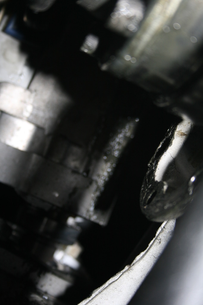

I will start tear down tonight, I just am worried about what happened to the roll pins! I didnt even think about it until I started looking at threads on removing the rear hubs. I am sure they were not in the trans snub, maybe still in the adapter... Hopefully...

Use longer CV bolts and attach the cage to the back of the output flange on the tranny using locknuts.
That way, if the CV comes lose on the tranny side, it'll just bounce around inside the cage.
It sould even hold long enough if you shear off the bolts and adapter as the flange itself is threaded.

I got the trans out and checked everything, adapter roll pins are missing, looks like they cam loose along with 3 bolts that broke inside the trans axle snub. when the axle came undone, it struck the rear shift bar putting a dent and bending the end to a 45 degree angle, big hammer fixed that, the starter looks repairable. I am hoping IMI sells just the plate to bolt the start to the trans.
New brake pads on the way, some welding to do and it should be on the road by next weekend stronger than before.

Need to be sure to check the outer adapters as well. I have always used red loctite on the adapter to stub bolts (since they are a PITA to check torque on after the car is running)

I used Red locktite, on all the axle pieces, the car has had about almost 2000 hard miles. I admit I am not easy on my cars... I believe this was a mix of me abusing a bruised and beaten part, and it FAILED. So welding the adapters is my soultion for the time being.
As for the wiring of the bolts, I will wire the axle bolts, but for the adapter bolts (that failed) it cant be done the clearances are to tight between the axle and adapters. Has anyone else wired them?
