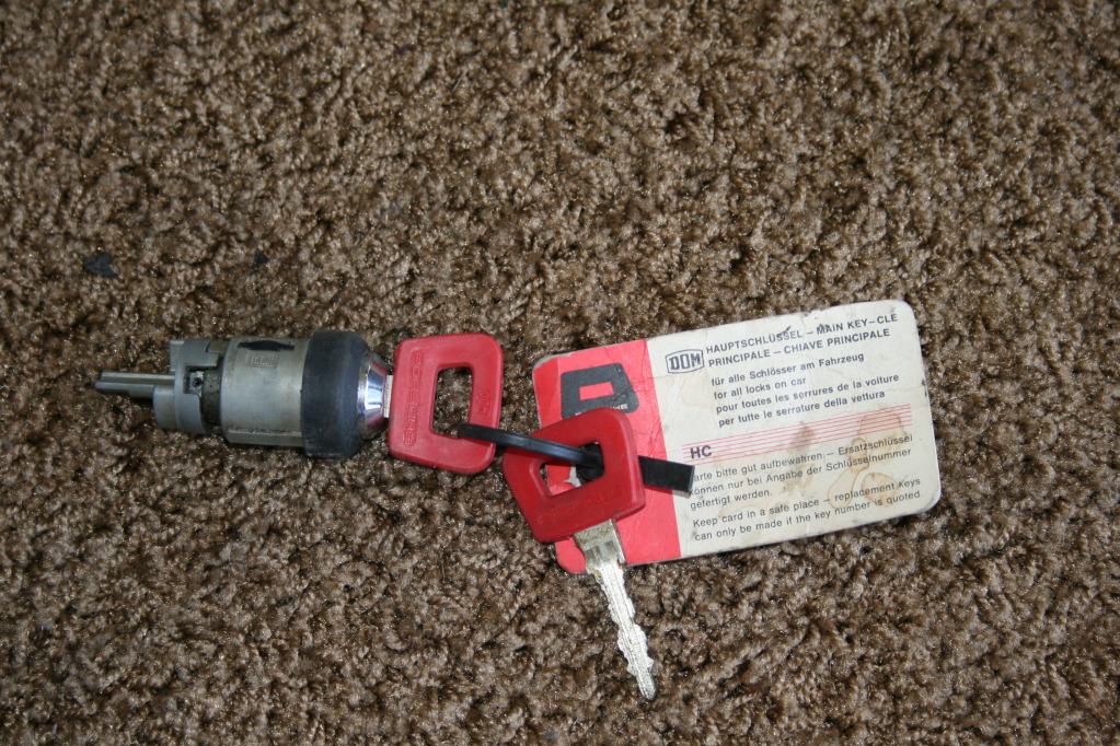

I just posted this in my garage sale, and thought I would ask what it is too...
I thought this was an ignition key, but I do not know. i was also told it could be a glove box key, if any one knows please let me know....
IPB Image
IPB Image
SLITS

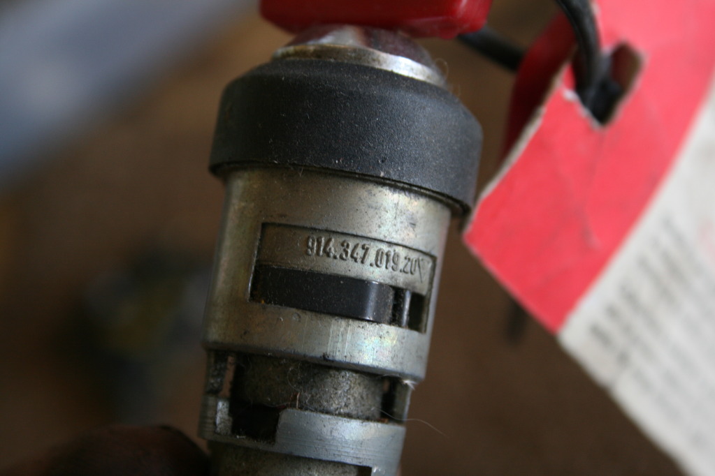

'75 - '76 Ignition Tumbler as far as I am concerned.
cgnj
QUOTE(SLITS @ May 30 2010, 04:20 PM) *
agree.gif I have about 4 of those lying around.
Carlos
Tom_T
Regardless of the tumbler (which looks like the glove box one to me) - the "key" which he asked about is the infamous Porsche red key used for the valets, that will only operate the door lock & ignition - keeping the front & rear trunks & glove box secure - IF it's cut properly to that pattern. I think that the red one has an extra or extra tall top shoulder cut IIRC & comparing my two blanks, but some folks have the keymaker cut them off to work on all locks.
