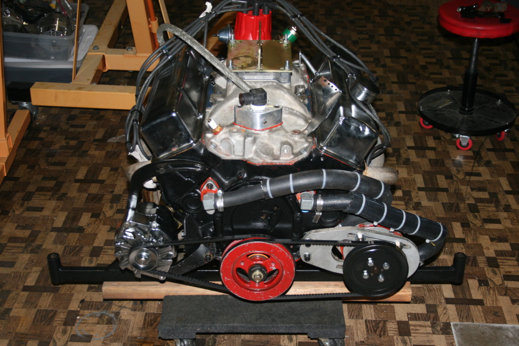

Thought I would post this for the V8 guys, I am one that like to use part numbers rather than trying to fab things up (most of the time). I found that Gates hoses, 21228 and 21391 have the perfect bends to fit the renegade pump and front engine fittings,with a little cutting. Buying an extra 2 of these I also was able to add a protective layer to each hose by slicing and zip tieing them over. biggrin.gif

Dont know why an extra layer of protection is necessary.. Most of the issues come in the form of the hoses popping off on the motor end due to pressure. I always double clamp mine and tighten them with socket wrenches. Looks like you got GOOD clamps on yours though

I noticed they were rubbing on the heads and they were close to the headers, also I have harnesses in my car with the 4" plate backing, the potiential of them somehow hitting that scares me. Better be safe and paranoid then on the side of the road...

Your concern is a good one and it's often overlooked by many. Chaffing hoses against corners and edges is a very real concern. Though it may not always look pretty, it can avoid real headaches down the road. I've done exactly what you have done even on race cars.
