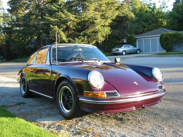

markb
Jul 12 2010, 09:45 PM
You really need to paint his back to stock. Aubergine with flares! Too cool!

What is the acutal paint code for this color?
JRust
Jul 13 2010, 06:00 PM
QUOTE(effutuo101 @ Jul 13 2010, 04:41 PM)
Thats a good question. Is the 98 the Aberguine paint code that you would take to get the paint? Or is there a seperate code to get it?
Jul 13 2010, 06:06 PM
QUOTE(JRust @ Jul 13 2010, 05:00 PM)
http://www.914world.com/bbs2/index.php?act=colors (scroll all the way to the bottom for 98 - Aubergine)
L98 or 98 - Custom Porsche Color
The 98 does not tell you anything about the actual color other than the fact that the color is a genuine Porsche color that was otherwise not used on your car model.
More often than not, a 98 color was a contemporary 911 color that someone wanted for their 914.

JRust
Jul 13 2010, 07:40 PM
So if I was going to get paint. I would just tell them Aubergine & paint code 98?
jmill
Jul 13 2010, 07:41 PM
QUOTE(Eric_Shea @ Jul 13 2010, 11:33 AM)
Agree... keep two:
1. Nice LE Creamsicle
2. Flared 6 Auberguine
Use the sell-off loot to get the six parts started.
Jul 13 2010, 07:52 PM
QUOTE(JRust @ Jul 13 2010, 06:40 PM)
No. 98 is not a paint code. It means absolutely nothing to a paint shop.
You will have to find the correct paint code for Aubergine/Eggplant for a '73 911 ...
Andy
McMark
Jul 13 2010, 07:58 PM
No, you can't tell them '98' that doesn't mean anything. The code for that color on a 911 is 025.
davep
Jul 13 2010, 08:03 PM
Aubergine is Porsche code 025
