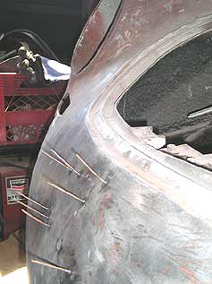

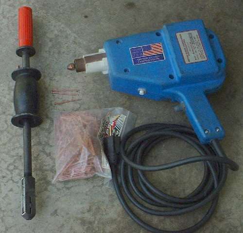

I do. And the hole drilling is so passé. B) Try a stud welder.
IPB Image
IPB Image
dr914@autoatlanta.com
we never ever drill holes in the panels. We use a puller that welds small "nails" onto the damaged area to which we attach our puller and then ease the dent out. This keeps the metal intact and also keeps it from distorting during the repair process.

I've spent an hour or more making a special tool to avoid this on many occasions. I have special shortened body hammers and very short homemade bullseye hammers for bumping out hard to reach damage. I have a stud gun but very seldom do I use it. Infact I think my son borrowed it out to a friend. I'm sure I will never see it again. dry.gif

BTW: Marks photo of the 365 is a classic example of the correct use for a stud welder. There is no way to get behind the nose panel to finesse out a dent.

My 75 had a long scrape/dent like from a rubber strip from a bumper in the door. It was inline with the beam inside the door. I actually bought another door from a member here to use but I pulled it out with the stud gun and I think I will keep the original door because it doesn have any rust in the bottom. I would rather have a skim coat of filler than a welded up door I think. The good thing about the stud gun is you can use it on gas tanks or whatever without drilling holes or welding. Sometimes though I have torn the metal from working one stud too much.

Got a question regarding the stud gun: I've always relyed on guessing how long to depress the button to weld the stud in place. Too long and the stud must be ground off. Just right, and a slight twist will break it loose without creating a hole. Is there a better method to gauge the time to depress the button?
