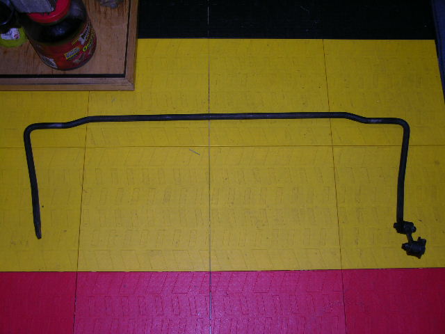

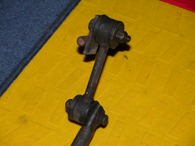

Hello,
I have a 1975 914 2.0, the car came with a rear sway bar unattached and missing the drop links and bushings on one side. I am trying to find out if this was a factory or aftermarket rear sway bar, I think it is aftermarket because of the U-Tabs attached at the base of the rear shocks.
I have purchased the weld in attachment plate and the bushings and tabs for the attachment under the trunk.
Can someone explain the procedure for welding in the plate, location etc..
I am also looking to purchase the hardware & bushings that attaches the bushings to the drop links, I have purchased the missing drop link which was a genuine Porsche Drop Link, it measures up exactly to the drop link on the sway bar.
I have enclosed pictures of what I have.
Thanks, for all of your great help!!!

My guess is it's a factory bar that's had the balls cut off and drilled for bolts.
DAPO mod.

I would guess H&H
