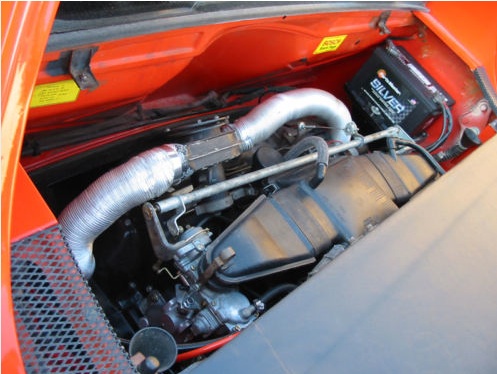

You might check into what was used on the 912's that had carbs.

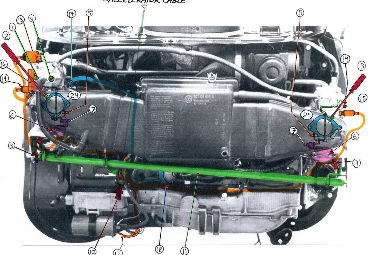

Didn't the euro carbed 914s come with a similar air-filter housing???

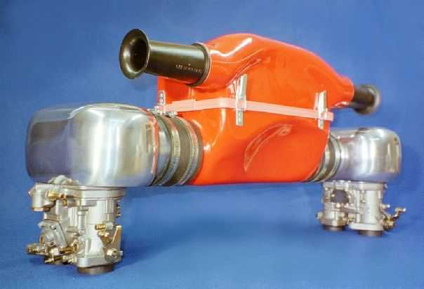

VaccaRabite
Somehting like this:
IPB Image
But the guy had made an all FG box instead that was less massive.

For smaller single stack carbs... (This car was on ebay a while back)
Here is another angle from a picture I found. I think they were on some VW buses and carb'd euro 914s. I could be wrong though. I'm sure a simliar setup could me modified for use with 40s and 44s. idea.gif

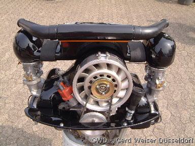

There are a number of GErman suppliers that do this give me a few hours and I will come up with some links... weber or dellorto?
jmill
Those are meant for turbo'd webers. I've seen the filter placed at the intake to the turbo not over the carb. You could use them and just use a Y tube and filter. Same craptastic K&N though.
veltror
http://www.udobeckertuning.de/picsparts/lufi.jpg
veltror
The red one pictured is from Klaus tuning pretty good product but also look at this towards the end of the page, this is what i would do if I went Carbs...
Luftfilter

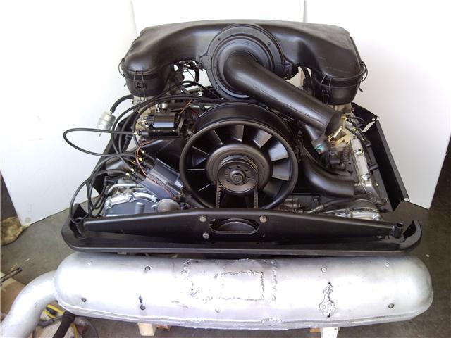

Root_Werks
Zach, I went through all of this a while back, researched the hilt out of everything. If you want to spend the bucks, you can get that kit listed in the link above. Although it's designed for a T-4 in a T-1 body, not a 914.
If you want, I have the early 912 aircleaner housing and new elements. The pass side fits, but the drivers would need to be modified as the cyl's sit about an inch too far forward.
I even have the adapter plates from solex to weber base's.

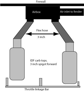

Here is my idea.
I'll take a modern airbox that used a regular rectangular air filter. it will be mounted tot he firewall. a 4 inch tube will go to the pass side wheel well, drawing cool air from there.
two 3 inch holes on the filtered side. Flex hose will link them to some carb tops with three inch inlets. Since all the filtration is done in the air box, the only purpose of the carb hats will be to feed cool clean air into the carbs.
I figure I can use my existing bases and tops. Where the filters go could be layed up in fiberglass.
With this configuration I should not impact any of the other function in my engine bay. The flex tube will give me vibration and movement since the engine will be floating on the mounts, and the air box won't.
This should give me plenty of air to breathe and really quiet down my carbs. Right?
Let me know if anyone sees a flaw in this.
Zach
QUOTE(Vacca Rabite @ Aug 16 2010, 07:07 PM) *

QUOTE(Root_Werks @ Aug 16 2010, 03:39 PM) *
Maybe this is a better option. Do these flow enough air, or are they restrictive?
Zach
Root_Werks
QUOTE(Vacca Rabite @ Aug 16 2010, 07:29 PM) *
Zach
Oh they have the room for the CFM for sure. The only downsides are:
Drivers side needs mod or else it bumps into the firewall just a little bit.
You cannot use stacks, just not the way the factory set them up.
I won't use them, you want them to just fart around with, let me know. Just cover shipping and the PITA it'll be to box them and they are yours. New filter elements and $100 adapters I bought.

Zundfolge
I wonder if one could simply modify the 911 one to work on a 4cyl car.
Maybe just need to modify the basees that fit on the carbs (maybe plug one hole on each base)?
Dunno if they're close enough to the same length to work though.
ldsgeek
QUOTE(Vacca Rabite @ Aug 16 2010, 06:07 PM) *
Here is my idea.
Zach
Be very careful taking air from the wheel well. A puddle (or even very wet road) can throw enough water to cause issues. Some of the rice cars use a water diverter of some type as they often take cold air from a wheel well or near the bumper, you might look for that part as well.

Looks like those Air boxes are 8 inches tall. I'm away from the car otherwise I'd go and measure it to see if it'd fit. Here is the cut-sheet for reference.
