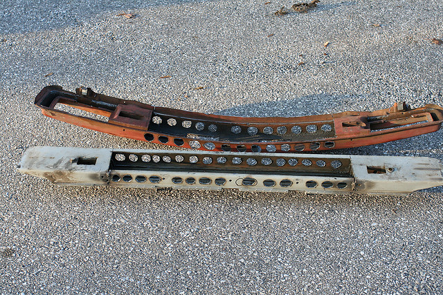

Dan I never put up my own post on it,but I know I threw my info out there. If you don't find it I can redo a post later. I designed & built the car with the semi stock d-jet to pass smog & it did! I did the same with my bumpers. I got 11.5#s out of the rear and 6.5 out of the front. I could have done more, but Ididn't want to completely compromise them.

front
DanT
Aug 19 2010, 11:39 AM
nice swiss cheese Andy
you used 1.5 and 2" hole saws?s how difficult is it to get the covers off of the supports?
I believe they were 3/4 and 1" and my large drill press. The covers were pretty easy to take off. I left them in the sun for a while. I think I used a screw driver to pop out the center of each rivet. Then just pry off each end. I don't remeber if I wrecked the rivets, but I replaced most of them. I think I got them at local flaps/pep boys.
