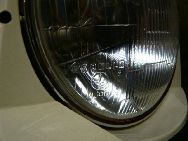

Eric_Shea
Carello H4's. Hella's would be easier to find though:
