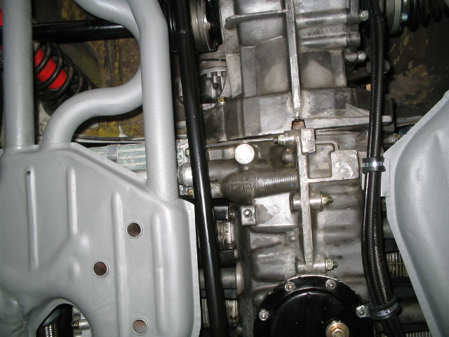

Had good results with GIBBS brand penetrating oil.
http://getgibbs.com/tips.php
IronHillRestorations
I like high temp clear
