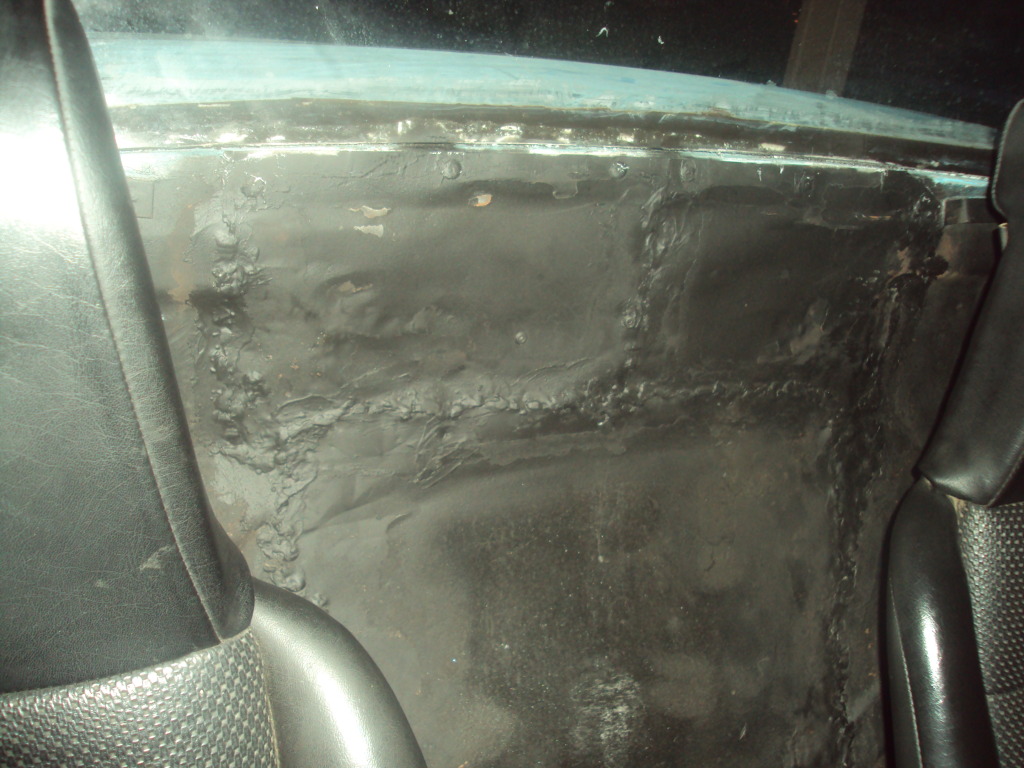

I got the car for free so its not that bad, but this car was definitely loved for a long time before the people before me had it. So far i have found no significant rust but some of the redneckery on this car is just hilarious. Pics will tell some of the story..
IPB Image
IPB Image

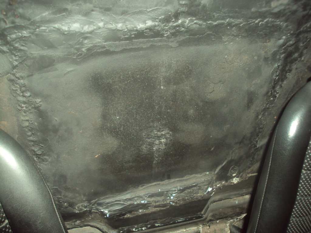

I think they got tired of welding half way through, and thought "screw it we'll rivet the top"
Anyway with the firewall being hacked to all hell and planning on doing a v8 conversion do i need to relocate the water pump or just cut out whats already "gone" and weld a box around it?
I know its long winded but, thanks for your input.
Kevin

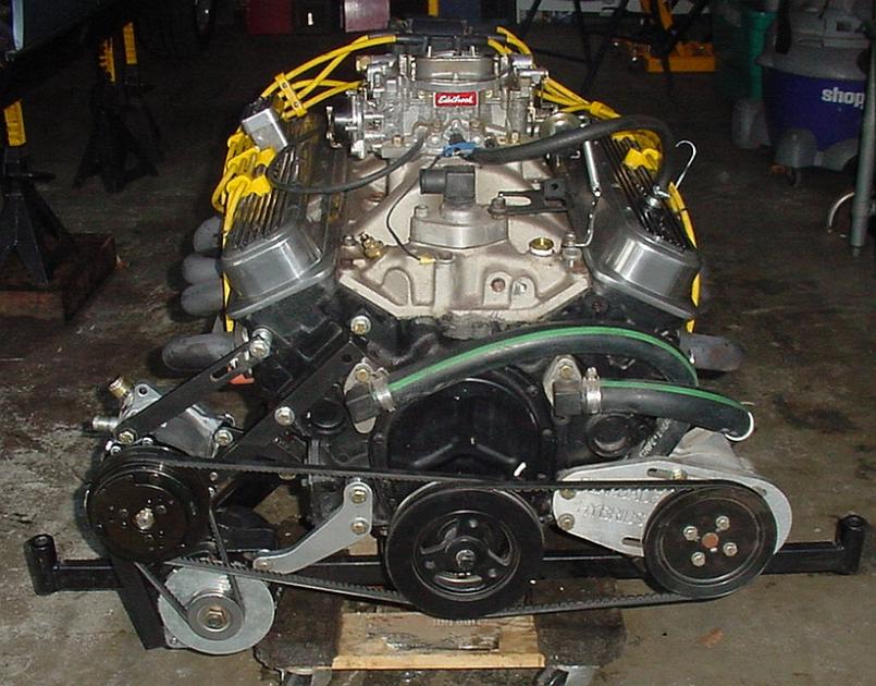

not only does using a stock water pump put the water pump in the passenger cabin - it makes installing the engine more tricky.

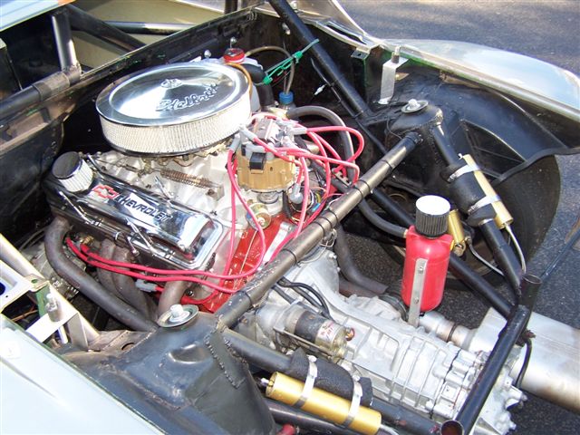

On a more serious note. If you use tall valve covers the drivers side recess for the seat needs to be bumped in about an inch. Something to consider when your welding in the new firewall.
IPB Image
Note the left valve cover and how close it is to the firewall. That is pushed back about an inch and a half.

Hey Jim what kind of pulley setup is that?
I'm not necessarily trying to cut corners or anything just reviewing some options since the car is already hacked.
I can see how a stock water pump would sit by looking at Jim's pic but that setup is definitely doable.

jimkelly
my pulley - i can not remember where i bought it - maybe jegs.
http://www.jegs.com/webapp/wcs/stores/serv...65899&Nty=0
maybe spectra 4369 ??
my pump was given to me froma friend who called it a sbc short pump.
note that whate ever engine bar you get, you will need the corresponding trans mounts - as they measurements go hand in hand. my buddy made both for my car - so dims are slightly different than that of renegade's stuff.
i would go all renegade if i were to do it again.
this ebay item looks like my pulley set - 400087851353
jim
