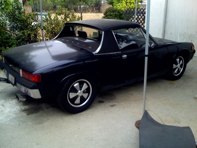

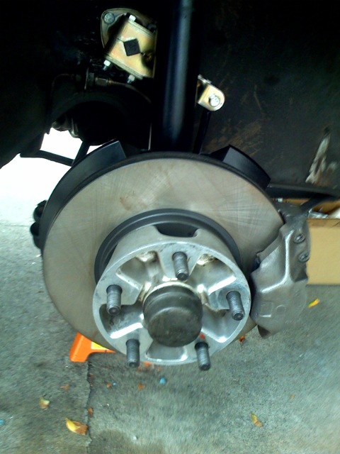

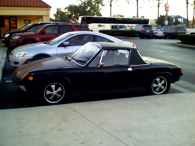

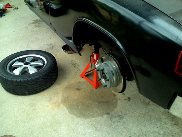

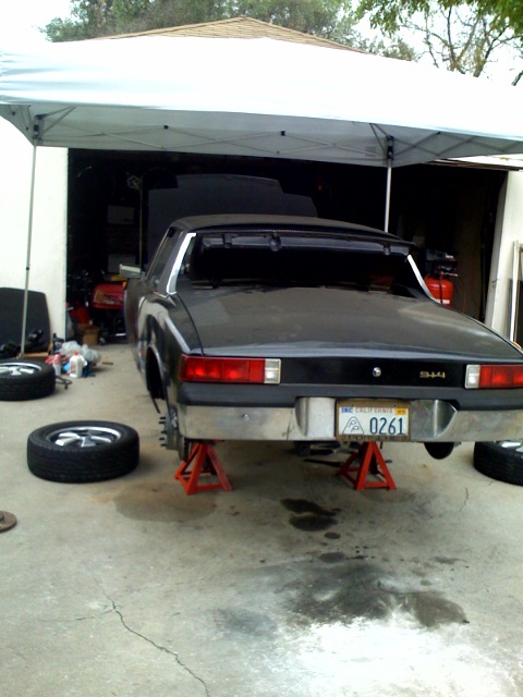

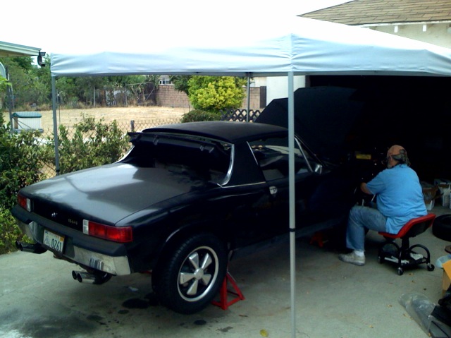

I just wanted to share a project that I had been planning for the last 20 years, a 5 lug changeover.
I had been gathering the parts for a long time and I finally said I was gonna do it, I set the time aside (planned on it taking 7 days but small problems came up and a total of 11 days) and here is the result.
Click to view attachment Click to view attachment Click to view attachment Click to view attachment Click to view attachment

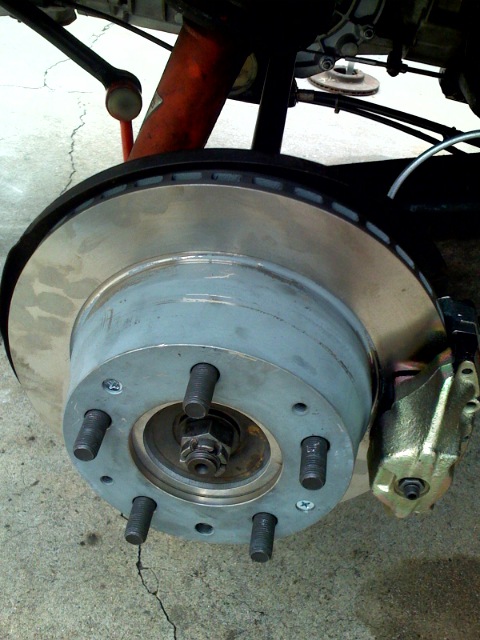

QUOTE(type47 @ Sep 16 2010, 05:11 AM) *
What stub axels did you use?
Hey type47,
The very last items I found were a pair of 914/6 stub axles, I was going with a 4 lug converted hub set up, so when I found the stub axles I changed, since I had a pair of '72 911 hubs on the shelf that had 60mm studs which I swapped out for the standard 45mm,) I am a bit happier because the 4 lug hub does not line up with the screw holes in the brake disk. Fastening the disk to the hub this makes it much easier to adjust the venting clearance and the brake disk is centered on the hub so balance does not become an issue.
Mike

A bit more than a month now and I needed to remove the drivers side front strut to tighten the ring holding the cartridge in the strut, (might have forgotten to tighten it down on assembly.)
I readjusted the front wheel bearing, used the Motive Power Bleeder to bleed the brakes, also cracked the fittings on the brake pressure regulator to bleed it, now the pedal is really firm.
The car handles GREAT! Glad I did it, anti sway bars and all....
Only one regret, I didn't install cross drilled rotors, I need to bring the weight down.
