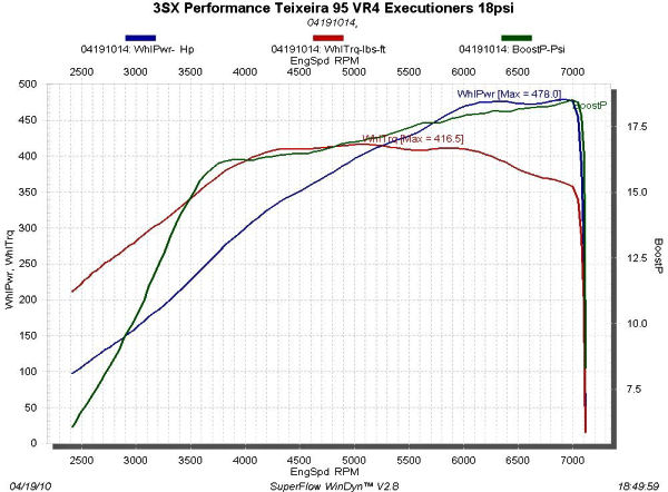

Seriously how much power are we looking at? Those automatics can shift quite fast, however they cant hold the power very well.

IPB Image
That looks like a good place to start. smile.gif Take in mind, that is a dyno graph from a 5000+lbs car with awd.
Andyrew
Thats a nice little torque curve! What vehicle is that?
RJMII
It's a 3000GT VR4.
