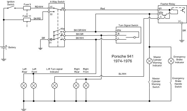

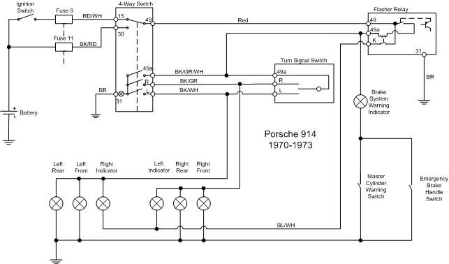

Here's simplified wire routing for turn signals depending if you have 70-73 or 74-76 914.
Start at the fuse and follow through to the lamps. Find the wires and follow them with your voltmeter.
If you don't have a voltmeter, buy or borrow one.
As far as the turn signal lever turning on the left and right side lights, this is a different switch than the turn signal switch. What you are turning on are the running lights, not the blinker lights.
It could be your flasher relay that is not working. You should check voltages before buying a new flasher relay.
