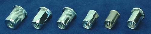

a nice clean alternate way is to use rivnuts or Nutcerts these are trade names of a captive nut, you can even install them in blind panel (no rear acess) ionstalls kind of like a rivet.
bugsy0
nutcerts or similar are the way to go - no burned paint, just as good for this application I would think and less "invasive"

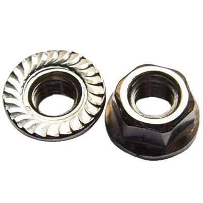

agree.gif remove the zinc plating before welding. It's going to burn off anyway, and the zinc will make it harder to get a good weld. Also, used flanged nuts for increased weld area.

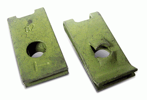

The nut inserts work great. Weld nuts are better but more involved. The fold over tab nuts also work without as much precision.
http://www.aircraftspruce.com/catalog/hapages/tinnerman.php

If you have an air powered rivet gun (or the muscles to wrestle a hand riveter) threaded rivets would be a really clean and nice solution for this.IPB Image
