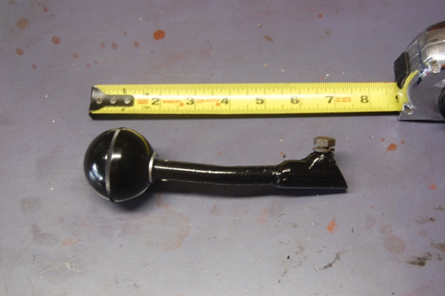

URY914
Dec 7 2010, 07:08 PM
URY914
Dec 7 2010, 07:12 PM

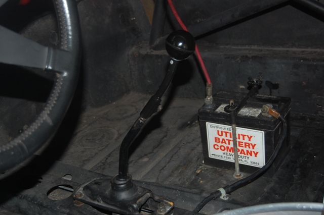

stownsen914
Dec 8 2010, 10:35 AM
I raised the shifter in my 914 track car something like a foot, and then cut the shift lever down to about 8" or so. It sits next to and slightly below my steering wheel, and I am very happy with the setup. No short shifter needed, since shortening the shift lever shortens the throw.
Scott

URY914
Dec 9 2010, 05:28 PM
QUOTE(yeahmag @ Dec 8 2010, 02:59 PM)
How does it feel with the added length? Is the throw super long now?
QUOTE(URY914 @ Dec 7 2010, 05:08 PM)
I wouldn't say the throws were super long but maybe a 1/2" longer. I do have a little more leaverage now that it is longer to it sorta feels like it goes into gear easier.
