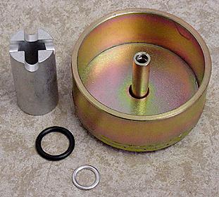

The 'tuna can' is a safer route. But I haven't seen a deep-sump-disaster in the shop or seen one posted on the site, so I don't have any first hand knowledge of the possible danger.

The only way to do it properly is to disassemble the engine and machine the case and stud the mounts. It is a lot of work for not a lot of gain. More oil isn't necessarily a good thing on an aircooled engine. If your engine was oil cooled like a 911 it would be ok, but the T4 is more aircooled than oil cooled. Takes longer to heat the oil up, so on short trips it takes longer to burn the contaminates off your oil, which in turn causes more wear inside the engine. Not worth it. I have run a tuna can and that is all I would do to add oil capacity. It will help keep the pickup covered.

Second to not having one my vote would be for a tuna can. Be sure you check the height of the extended pick up. I had to "massage" mine to perfection.

tuna can bolts to the stock bolt that pulls on teh case. it leaked. I dont like it. deep sump however, does not use that weak point to hold it on. 10jreen is very low and we havent hit it yet. Ziggy had one for 5 years, never hit. white whale had one for 3 yrs, never hit. yeller has one but I only owned it for 6 months, never hit.

i have seen 914s starve out a tuna can in a sweeper. deep sump has alot of surface area to cool. tuna cans dont always go on straight because that stud coming from teh center of the oil pick up can be off center making it VERY difficult to seal it up or even mount it correctly. I have also seen many cracked cases from over torquing that center stud that the deep sumps i have installed dont use to hold the sump on.

have been using "tuna cans" for 20 years on 4 of my 5 914s (one was a 2.7-6
and if installed correctly and carefully I have never experienced any issues and no oil starvation. These cars have all been heavily AXed and 3 of the 4 have been extensively used on track as well (my current car just has not had the chance to get to the track as of yet
