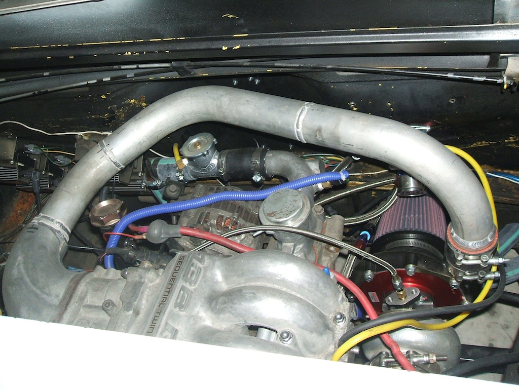

Here's a picture of one for the Non beleivers... Courtesy of Rotary14
Or if you want super high HP and a custom install. Go this route... T.M.C. (Too Much Custom) barf.gif

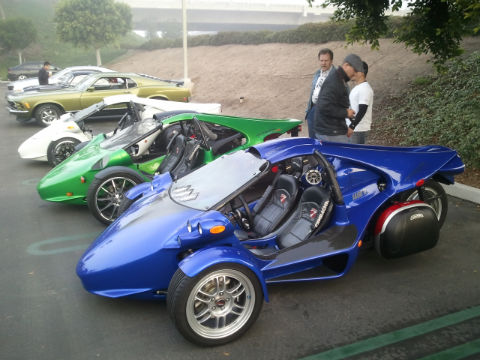

happy11.gif My father in law has a busa, still in the bike, I wonder if he would notice it missing. happy11.gif The T-Rex is a cool cart!
