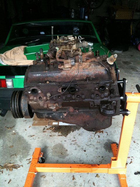

First, lay out your tools on the rear trunk of your old Porsche. Only the finest work jacket will do to keep the paint scratches to a minimum.
IPB Image
For tear down you need 4 wrench sizes (all inch sizes). 3/8, 7/16, 9/16, and 5/8th. You will want to have these sizes in deep sockets and wrenches. You will want to have at least one breaker bar to break torque on most of the 9/16 and 5/8 bolts. Also a rubber hammer, pry bar, and scraper will be needed.

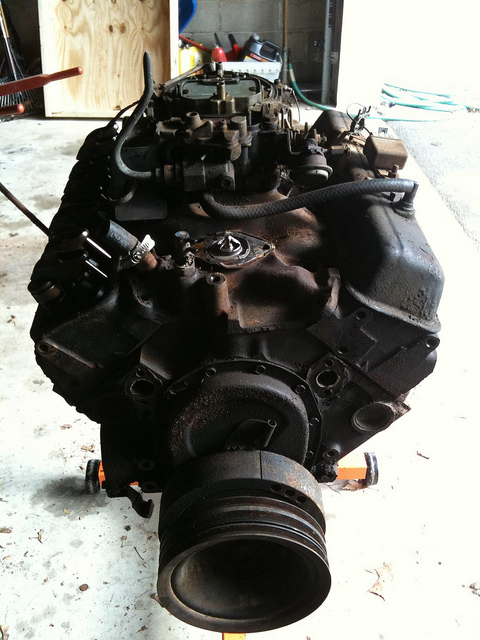

The beast:
IPB Image
This is the engine that I am going to be tearing down. It was pulled out of the donor truck Dec 10th and mounted on the engine stand the next day. Don't even think of trying to do this without an engine stand. This 1000 pound stand only cost $50, and it is money well spent. Fair bet my 914 has a little bit of engine envy right now....

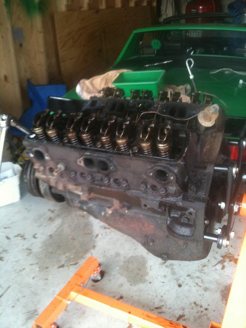

Valve covers need to come off first, as they impinge removing the intake. One off in the picture above. You need a 7/16 deep socket to take off the nuts that hold the valve covers on. Lots of sealant was used here.
Valve covers, carb and intake are off.
IPB Image
IPB Image

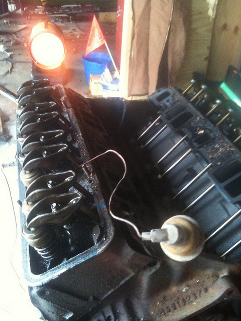

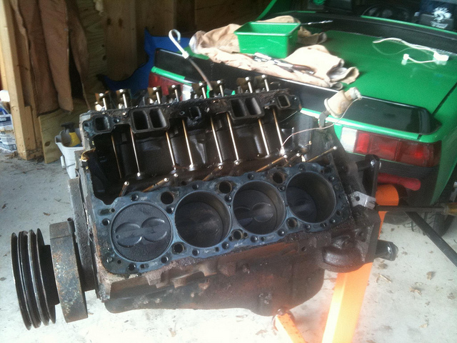

Pretty easy so far. Time to go for the heads. The rods going into the block are all the push rods. They come up from the cam and operate the valves. The orange ball of fire is my heater. 70K BTU of warmth to stave off the cold, even with the garage door open. I even had to take off my warm overalls, as I started sweating with the heater and the overalls both. The intake was attached with 9/16th bolts. There was considerable sealant used, and getting the intake off was difficult. I ended up using a pry bar to get it started, and hold it up enough to get my fingers in there to pull the rest off.
First head is off.
IPB Image
This is the point where I had to do some soul searching. It was pristine! The cylinder walls look like they were just done. There was no carbon ring at the top of the cylinders, which is common for an engine with miles on it. The PO of the donor truck said the engine had been rebuilt 4000 miles ago. But given the condition of the truck and the electrical system (the spark plugs were rusted and fell apart on removal) I had my doubts. Now, though... it took a fair deal of will power to not just button the engine back up again and put new heads and intakes on it. But, I am a stubborn man at times... I am going to rebuild this engine, darn it! This is how I learn. The heads bolts were 5/8s and were heavily torqued. I needed a breaker bar to get them started.

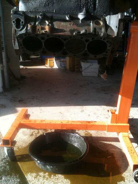

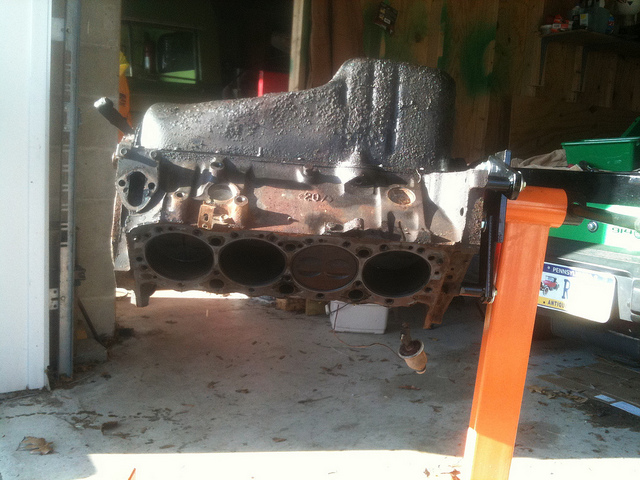

Heads are off, and it’s time to remove the oil pan. Remember to drain the oil BEFORE turning the block upside down!
IPB Image
When the block is turned over, all the coolant still in the block will drain out. This took me by surprise...
IPB Image
By the time I got a catch pan under the block, it was a bit late.... Live and learn. Lesson, just because the block is on your stand and you think it’s fully drained - it isn't.
The oil pan was held on by 3/8 nuts (I think it may have been 7/16...) with 9/16 bolts at the ends. Once the bolts are free, and the keepers removed, it still took a few good whacks with the rubber mallet to get the pan to come loose.
IPB Image

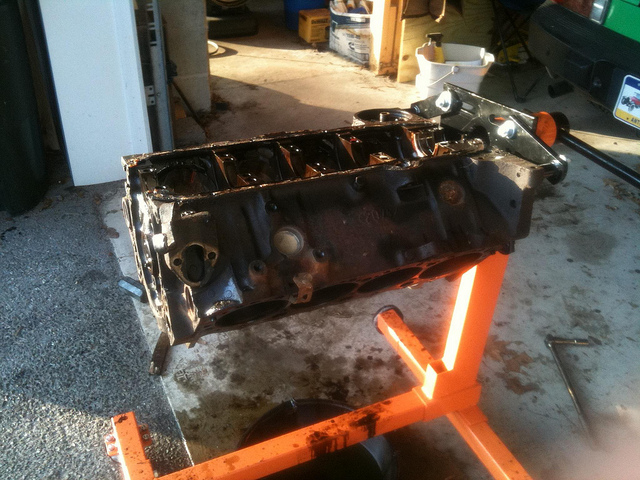

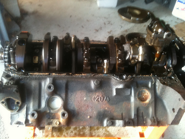

Oil pan is off. Now you can see the oil pump, crank assembly, and the tip of the timing chain.

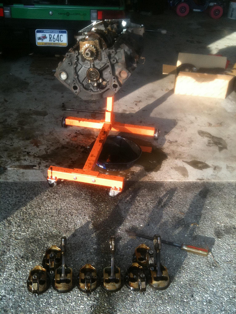

Time to start removing pistons.
IPB Image

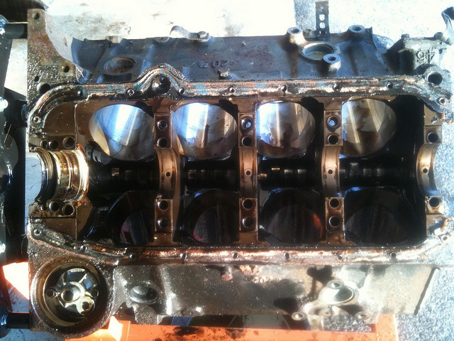

In this picture you can see what makes a "4 bolt main" block. On most Chevy small blocks the crank is held in place with 2 bolts on the keepers. As you can see, these keepers have 4 bolts each. Looking down into the bore you can see the honing in the cylinder. Rods were fixed with 9/16 nuts, and I needed a breaker bar to get them loose.
IPB Image
8 pistons and rods ready to be moved upstairs for cleaning and possible re-use.
IPB Image

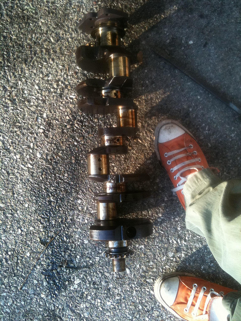

Crank is now out. They call these engines "mouse motors." There is very little small about them. My size tens for reference. The crank may get reused, or it may not. One of the bearings was very worn, which was troubling. Only one of the bearings was worn, the rest looked great. But one of them was through all the babbit material and almost looked like it had not been changed when the engine was rebuilt. Or it could mean that the crank is bent slightly - which can happen.

The cam is still in the block. I have not yet figured out how to remove it. Pretty sure I need to pull the freeze plug at the back of the engine and slide out the cam. But aside from that and a few bits and bobs, the engine is now totally torn down, and I am ready to start cleaning the block.
IPB Image
IPB Image

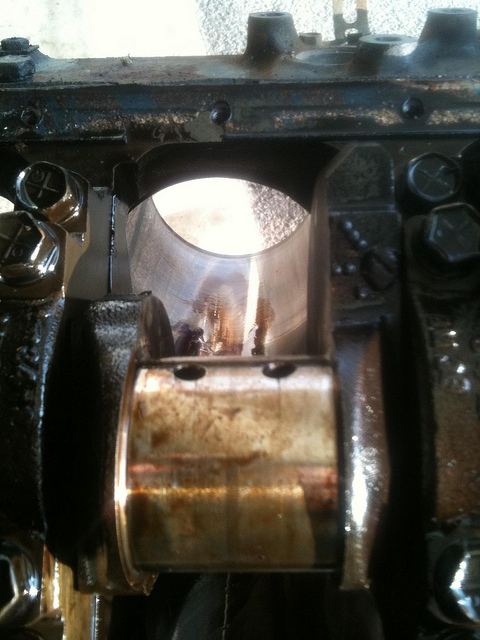

Something need turning somewhere. The main bearing was trashed. Someone in 715 land said it could be a bad rod, but all the rod bearings looked good.
QUOTE(messix @ Dec 21 2010, 02:17 AM) *
oh !!! and those "keepers" are called "main caps" DO NOT MIX THOSE UP! keep them in order by number and how they came off [front to back in the saddle they came out of]. if you mixed them up you'll be paying for a line bore.
same with the rod caps keep them together and exact as they came off!
DERP! Guess I will be line boring. I think I know how the main caps came off, but I don't know I know how they came off. An expensive lesson. sad.gif
The rod caps are ont he correct cylinders, but I did not not them end for end, so they are probably wrong too. sad.gif

IPB Image
IPB Image
So, what’s next?
Well, obviously, the cam needs to come out. However that works.
Then I am going to pull all the freeze plugs and start cleaning out the galleries. Oil and sludge build up in the galleries and that can hurt the engine over time. CLEAN CLEAN CLEAN.
Also, I am going to do some dressing on the block. Open up some oil drain holes, take off rough edges, and do other things to improve the qualities of the block. Then the block will go to my local machinist. I need to find out what size everything is, and let him run it through the hot tank. I am pretty sure the cylinders were cut to 30 over, and I do not think that they will need to be recut. I do want to see if the crank needs to be standard or over. That will affect bearings and what parts I get. I'll do the hone job when it gets back. Then clean it some more, and paint it.
So thats all I have for today. I'll update the thread as more gets done.
I have to say, it is very tempting to put this into the 914.... Especially if I build the 383.
Zach

There is a problem either with my current crank or one of my rods. Or the shop that did ,y engine reused a bearing. but the wear pattern for the journal is weird. the engine may need line boring anyhow.

I am nearly done stripping the block for the machinist. I know, slow right? Well I took a few days off for the holidays, and then took a few days off due to a stomach flu, so this is only really day two.
How do you remove the cam bearings? I am reluctant to tap them with anything as I don't want to scratch the case under the bearings. Is there a special tool or something for this? Or do you just grab a drift and tap them out.
All the freeze plugs are out. That was a sucky job as I knocked the first big one into the water jacket before I got the technique down. Got it out, but there was cursing involved - mostly covered by the music coming out of my garage.
I also ported the oil return at the end of the top of the case. The casting was ugly, so I cleaned them up. I am going to stay flat tappet, not going to go roller for the cam. I don't mind using high zinc oil - its not like this truck will have ANY emissions equipment for the zinc to burn out. If Brad Penn has a break in oil suitable for a 350 (and I bet that they do), I'll use that when I run in the cam.
The engine is off the stand, and ready to be taken to the machinist tomorrow.
