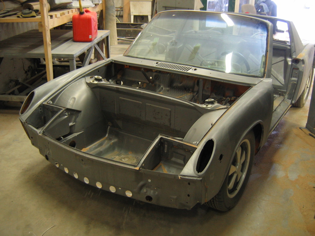

Getting ready to strip the paint
IPB Image

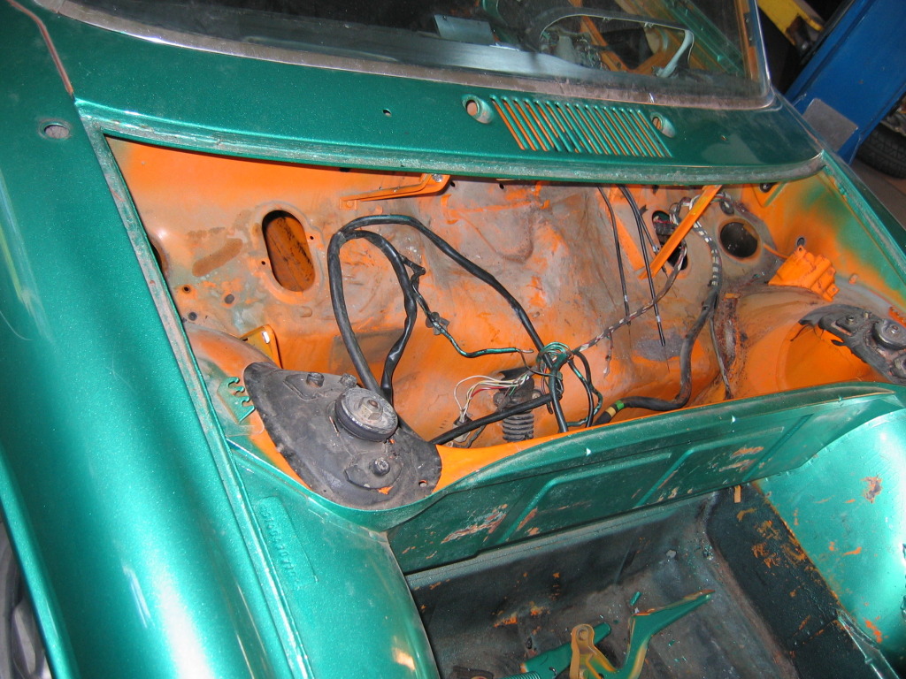

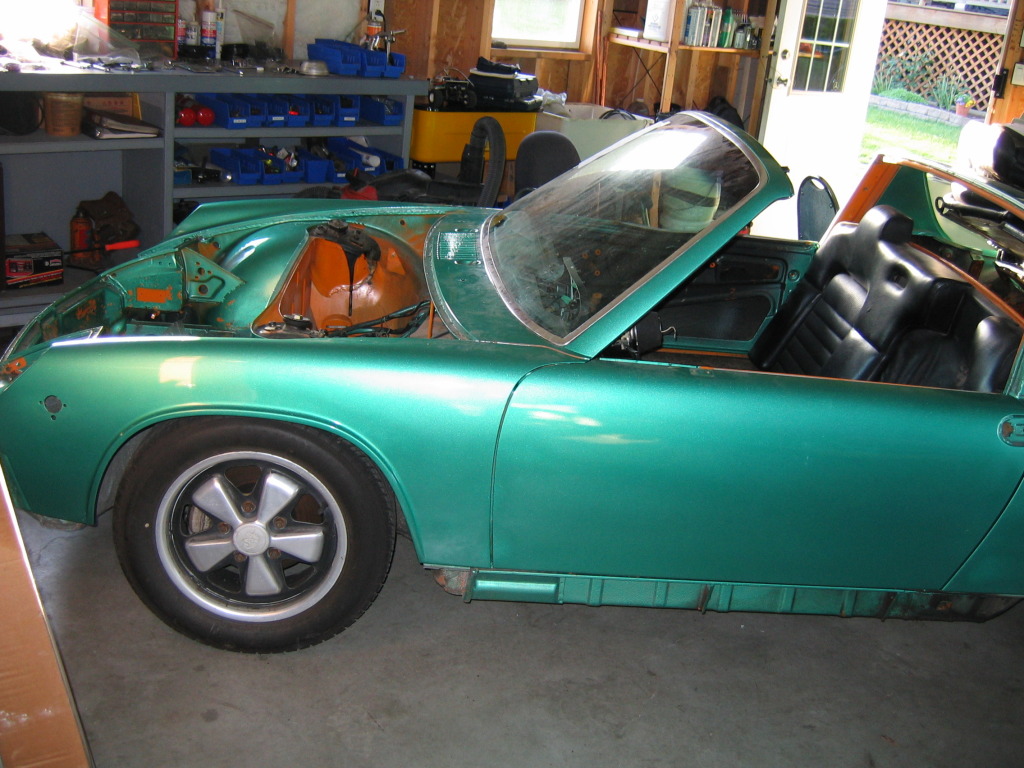

Original paint under fuel tank paint color decided
IPB Image

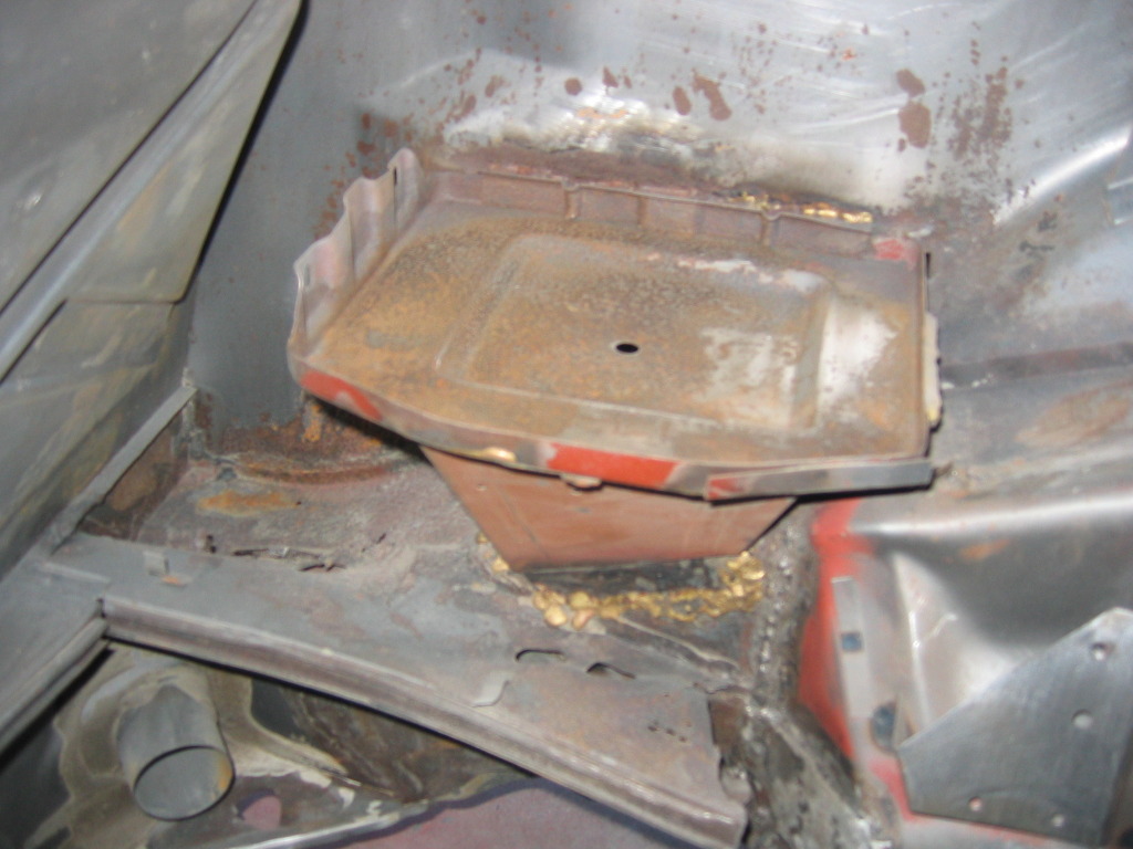

Nothing abnomal here,all was replaced
IPB Image

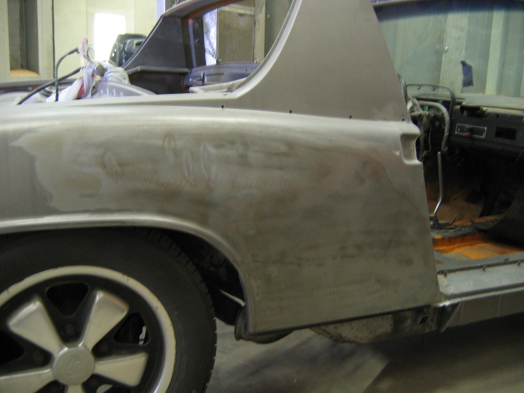

Some minor body damage
IPB Image
Eric_Shea
Looks awesome... can't wait to watch this one. Love that black paint dripping down the front shock tower in the first picture... perfect!

Looks like a nice, straight chassis. It should look great when returned back to the Signal Orange color.
Be sure to check the hellhole (underneath and in front of the battery) for rust before starting any paint project.
Does anyone know why the factory painted the top of the shock towers black on the factory -6s? Mine is done the same way, and I could never really figure out why.
Eric_Shea
I told Paul, who owns this car, that I believe it was a tad more attention to detail on the -6's. The factory set up the suspension and painted it black to mark it as set. Any adjustments post that painting process would be noticable.
It was a sloppy brush job with a flat black paint.

Looks like Blutorange to me , but colors on line are iffy.
The metal looks great. The brased in battery support is so 20 years ago. And ugly.
Fill that wrong side antenna hole and forget about a radio, can't hear it anyway. What's the VIN ?

Car looks really nice. Amazing job on stripping the paint. How was this done?
02jake
The paint stipping was done with walnut shell. I prefere this method, less heat and less abrasive. I have not tried soda blasting, I understand it is a good way to go. I will get some pics of the finished paint at the end of this week. The "hell hole" was completely and properly rebuilt. It was one of the better ones I have seen.

The job the walnut shell media sure did a nice job. How much time did this take? What grade and how much media did you go through?

c)the hell hole actually was heaven. Not more than marginal surface rust at the bottom in the engine compartment. The car, beneath the hideous repaint, was remarkably free of rust....just the battery tray area, and some small areas in the gutters of the front trunk where the seal sits.....and only evidence of body damage was to the right rear quarter, and a bullet hole in the left rear quarter

e)to rgalla9146...GEEZ...I should of sent you those pics 5 years ago. You just HAD to notice the antenna on the wrong side.... I didn't...the car has fresh paint, and I lost a lot of sleep last night, all cuz of that oversight. I am so @#$@# at myself. You'd think I would notice that one....I"ve had 5 years to pick that up.
Maybe now someone can educate me....cuz there is no evidence of a hole on the drivers side being patched/repaired. Did the factory predrill ALL of the cars...or did they leave it to the dealers.. Please, someone out there tell me that the factory did them all, and Hans decided on an ad hoc basis which side would see the drill.
If it is wrong....there is an area in the engine bay that probably needs to be sorted out...and I may be sorely tempted to have the shop patch, paint and drill....
ARGHHHH
The car is signal orange, it's just the pics...it is a 1970...710...so was on the same assemblty as 705 and 709 GT (trainers)
The battery tray area got nicely cleaned up

h)the car was sent to a shop to walnut blast...no idea how much media was used...but I daresay it was done pretty quick...don't think it was at the shop more than a day or two...Jake can set me right. Be carefull if you use it...can warp flatter areas, eg, doorskins and front and rear lids....we stripped those first before it went out
