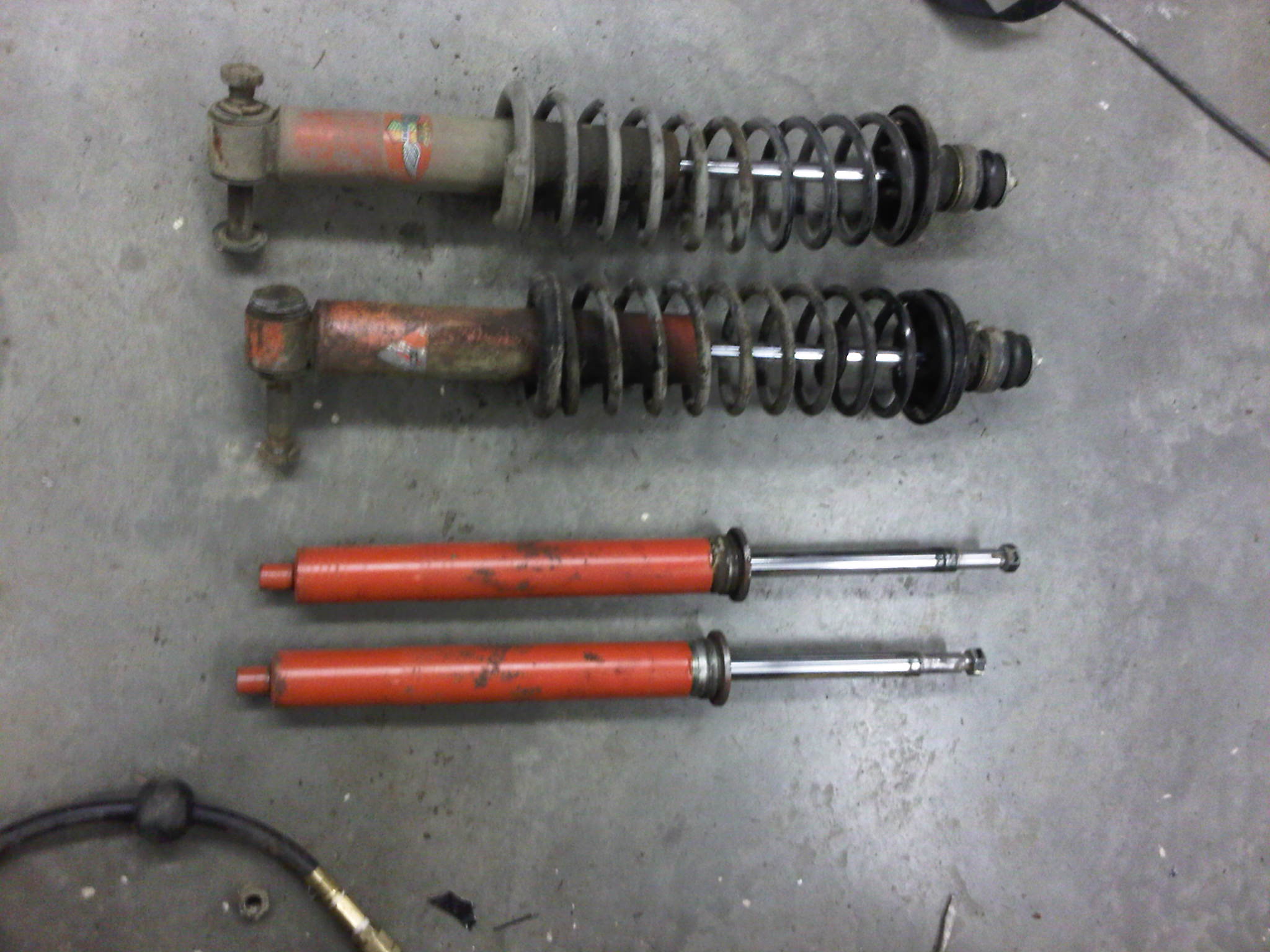

Took off the struts and shocks and found these. I'll need to take the spings off the rears to see if they are good but i think the fronts may be pooched.

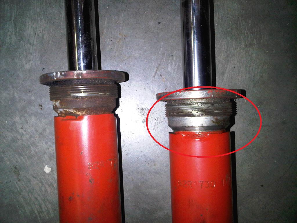

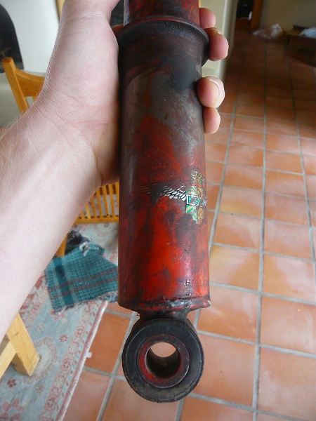

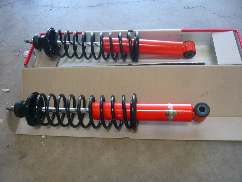

I sent mine off to TSM last spring. I got them back pretty quick and it was only slightly more than on the web post. I had two orange koni classic rears rebuilt. The only thing I'm not sure of is whether they still remain adjustable. That said Mine work Great!
Click to view attachmentClick to view attachment
I did the painting work myself, and new stickers are available from most mustang restoration sites.
Eric_Shea
Good haul... and good work on that paint job. Yes, they're still adjustable. From my experience, you'll want to set them on full soft for the street. This will give you a firm "European" ride.
