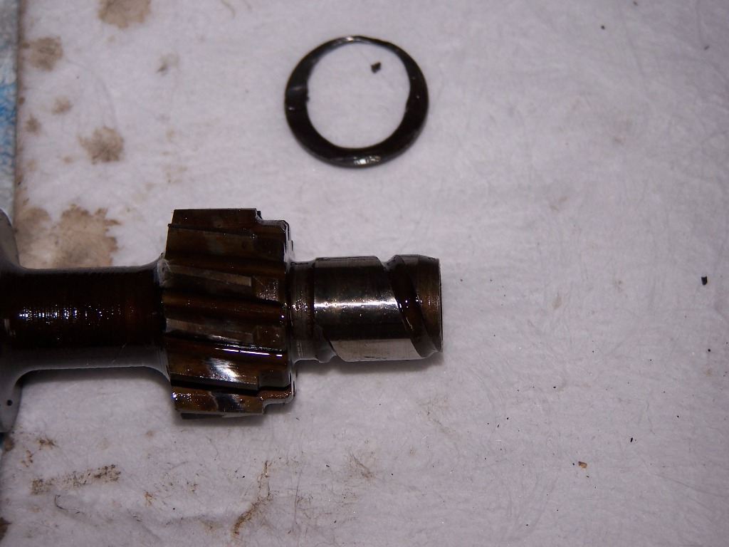

I finally split the cases on my 2.0-4 and found the washer under the dizzy drive shaft wearing funny. This being my first tear down, can anyone tell me if the notched area on the bottom the drive gear is normal or not?

Its normal. Where oil flows.

I'm not talking about the oil groove. The "notched" or "stepped" area of the gear itself.

Looks like the ones I took from the 3 engines I took apart.

Yep. Normal.

agree.gif Looks fine. The washer is FUBAR though.

Yeah, the washer is toast.
Was there no spring under the dizzy? You want to make sure you have it. That may be the reason the washer is toast.

Clean and I'll tell you... lol-2.gif Old oil eh?
