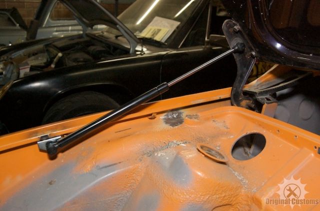

I was wondering if anyone has replaced the old torsion bar lifting system on the rear trunk lid with modern hydraulic lifters, seems like a pretty simple deal, Pictures anyone?? Thanks.

Camp 914 has the kit for around $50
McMark
Jan 3 2011, 02:07 PM
Fitted the camp kit and it works brilliantly - you do get used to holding onto the engine lid as you open it - as they have a lot of power and can push it up pretty fast!!

All my cars have been fitted with the gas shocks ... cut those MFer torsion bars out and never looked back.

They do not interfere with the top. I had to remove my torsion bars anyway to clear the fuel injection on my 3.2 motor anyway. The down side the shocks ware out, but are easily found at your local auto parts store.

I'm going to disagree with the conventional wisdom here. The torsion springs work great and they never fail. If you install the shocks, you'll need to cut the sheet metal on your trunk.
The factory got it right with the design of the torsion springs. Don't replace them.

Except when the trunk hinges tear off the inner fenderwell. Which seems to happen to almost half the cars out there.

I have struts for the front and rear trunk. I like it WAY more then the springs.

I can't. I bought it as a kit from Camp914 a few years ago.
but I don't think it would be hard to source the materials to DIY it.

The instructions that are included suggest cutting the trunk. I installed mine with the parts included with the kit without any cutting. So easy even I could do it.....so that means it is REALLY easy.

I did not have to do any cutting with my rear trunk either.

Another option (I went with and am very happy with) is the JWest rear trunk pivot. Much stronger than the original setup, but reatains a more stock look. (no shocks)

Change the mounting positions. Mount the shock further *back* on the deck lid instead of the hinge. That way it doesn't need to go into the engine bay. Then move the mounting point on the trunk accordingly.
There is still enough leverage that the trunk lid shuts easily without too much flex.
