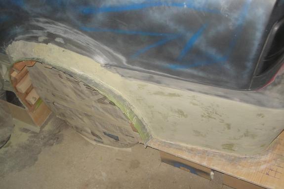

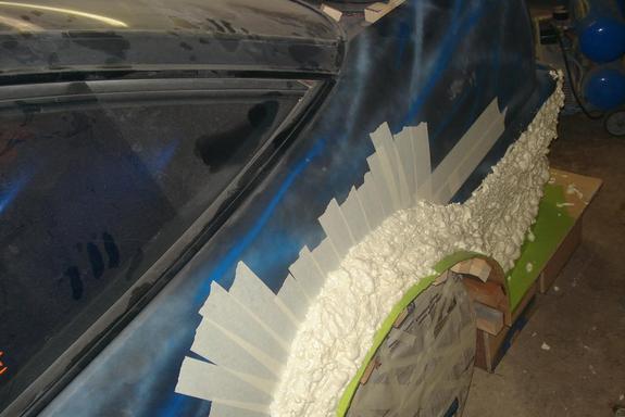

The spray on foam seems to be used also...
Before
After

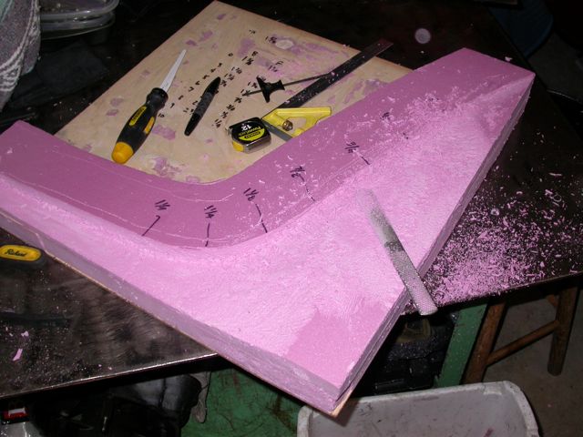

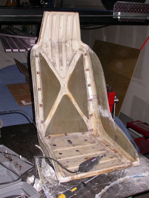

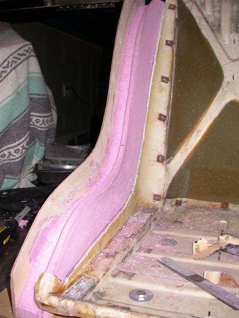

Use the pink stuff from Home Depot. You can rough the shape in with a course wood file, then finish sand to shape w/ 80 grit sandpaper. But, you need to cover it with something before laying fiberglass over it, the resin will melt the foam.
I just used it over the holiday to make a mold for my "GT" seat project. Worked great and now I have two 914 seat shells w/ extended bolsters. cheer.gif Next step is to learn how to do upholstery.

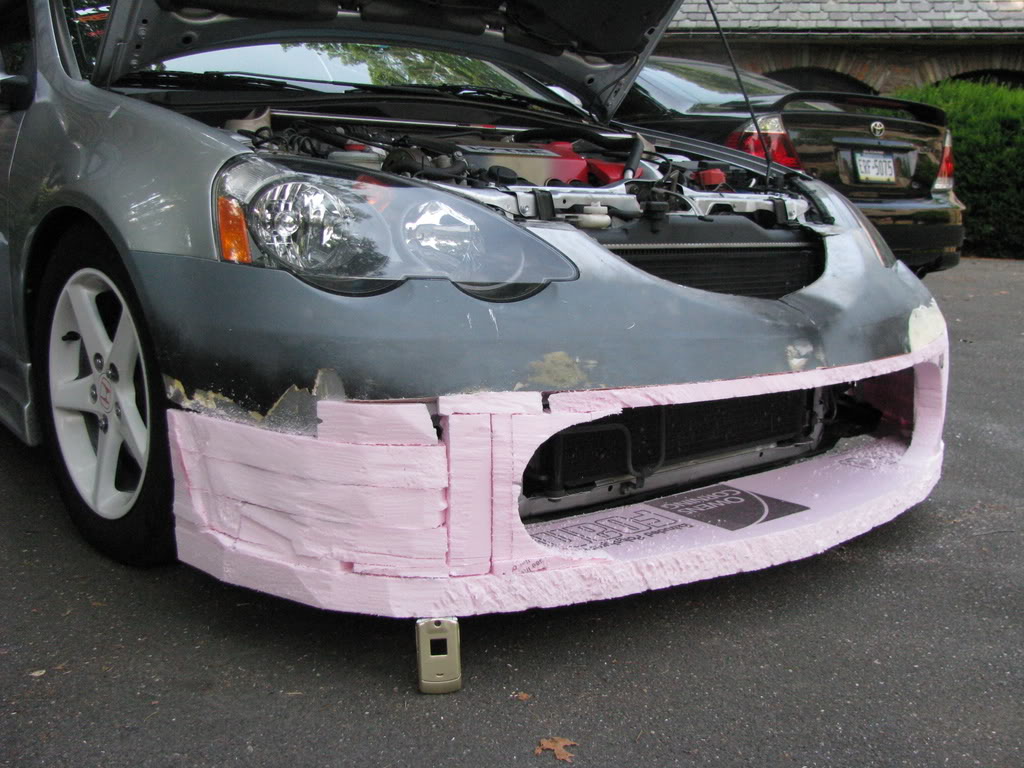

You're not going to find anything cheaper than foam sheet and the spray can foams. Here is a shot of a ricer that had his front bumper using the only stuff from Home Depot, so it can be done on the cheap. Fill in the voids with the spray foam and make your female mold. It will take some work to get the mold perfect.
