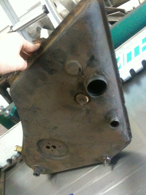

I have this oil tank from a /6 thats going in my car, any recommendations on cleaning it? Can't sandblast it.
Jan 7 2011, 06:02 AM
Looks nice enough that you might not have to strip and replate with copper & paint. Maybe just a citris cleaner? But you should still get the inside very clean/rust free. Pressure test is also a good idea so you don't install and find an oil leak.

I'd be leary about sand getting left behind and effing up you expensve motor. I heard people take these to a radiator shop and have them cleaned there.
ME733
Jan 7 2011, 09:58 AM
....... I have done this, Remove all fittings. Take the tank to your local do it yourself car wash using the degreaser you brought,and clean it as good as you possably can. Then take the oil tank to a recommended radiator shop for a through soaking and cleaning. A little extra $ on the side will get it steam cleaned inside. Hang around and watch...$$.., Then take it Home and flush out with soap and water, and finish with water. Use your shop vaccum on the suction side to help air dry it. Paint it with EPOXY PAINT....let it sit a day to ensure its dry. Put some marvel mystery oil, or lightweight motor oil in the tank and slosh it around. Install Fittings and tape up all openings. Your tank will be ready to use.

I did the same as ME,except when I got to the end I used a por 15 treatmrnt that involved a product called marine clean, then I coated the inside of it with some sort of por 15 epoxy that dried really hard.Been eight years and no problems.Also did the inside of my gas tank with the same product.

Took mine to a local radiator shop - it came out great. All of the gunk is gone from the outside, as well as a good portion of the paint, but the copper was 100% intact. They checked it for leaks and then rinsed it and sprayed the inside with a thin oil to prevent any rusting prior to install. They told me to throw some cheap oil in it and really slosh it around, then drain it. I plan on doing this a few times prior to installing and using it.

If you take it to a radiator place make sure they don't put any access holes in it.
I got a ruined 911 gas tank that way.
I was able to clean up a varnishy / rusty gas tank was with a product from this company. safest rust remover.com
This stuff has no terrible odor and is water soluable.
I'm familiar with 6 oil tanks.
Probably best to imerse the tank a few times in various positions to insure complete contact on all interior surfaces.
I kept the solution warm by placing a heat lamp nearby.
The pressure test is a good idea and a radiator shop can certainly do that.

When I called around, I had the same challenge. All the radiator shops around here got rid of there hot tanks. If I can't get it hot tanked, I may use Hydrochloric (Muriatic) Acid to remove rust and scale and then neutralize the tank and waste acid with baking soda. I think it's probably an enviro issue with the hot tanks so I wouldn't be surprised if CA has eliminated them. You can get the acid pretty cheap at a pool supply store. If someone has a better meathod I'm listening. Mark

Found a place! Guy says about 100-120$, does that sound about right? Don't wanna be one of THOSE guys
Also, is there anything I need to know when taking it. Pressure limits? Do's and Dont's.

..............CAUTION......Radiator shops use Water soluable oil. It,s thin and will evaporate, leaving water in the tank which will cause rust to form. Do a finish cleaning process before you store the tank., not just when you plan to install it.

I did one a few months ago. It was $50.00 to get it boiled out at the radiator shop 35 miles from me, nobody closer would touch it. I washed it out really well with mineral spirits and then lacquer thinner to get their acid & water all out of it and then let it dry out in the sun for a few hours before I painted it with Wurth semi-gloss trim paint. Came out way better that any part that you can't see should have.
