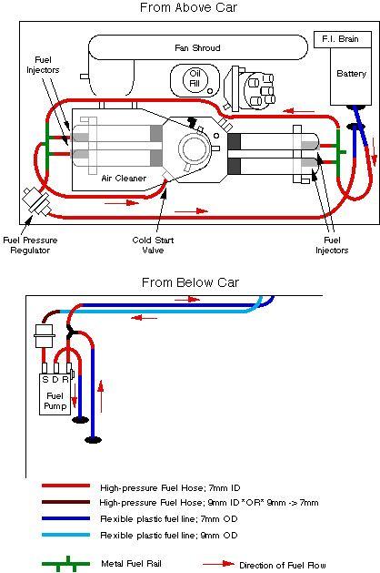

Diagram Below.. is for the 3 port fuel pump, you get the idea though and need to check all lines, fuel pump and connections ect. including under the fuel tank nipples, also some fuel tanks develop rust pin holes where the tank sits, there are 3 glued in foam rubber pads under and on side of tank (not the 2 you can see while tank is installed) that tend to hold water and create rust bubbles, potential holes ect, good to inspect those too.. I replace those with solid rubber while the tank was out..
