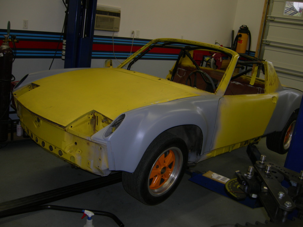

We recently started on the prep of a vintage 914-6 GT build. Starting with an original 914-6, and using original factory parts, this will be on the track this summer.
The owner asked for a bolt in cage replicating the factory GT cage. We just happen to have one as an example, and are replicating it with updated attachment, size, and safety requirements.
The original 914-6 with factory steel flares already attached.

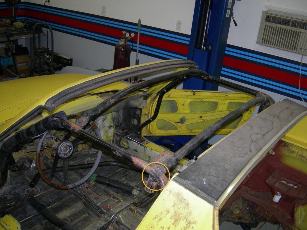

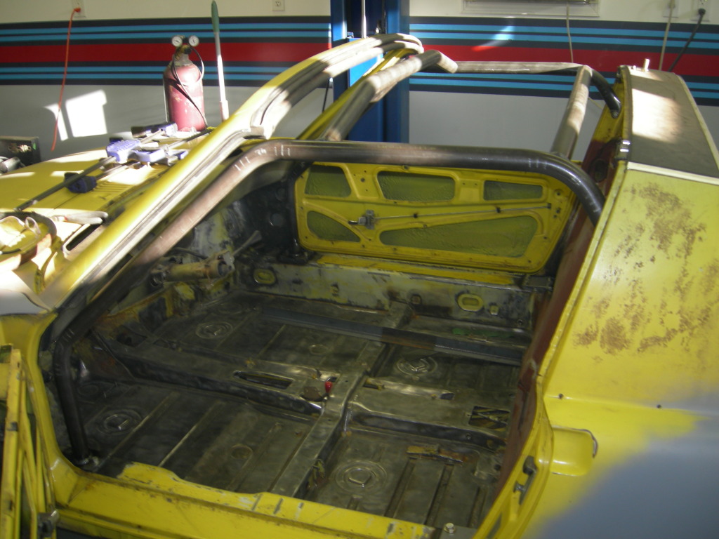

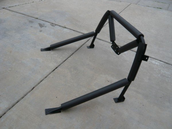

This is the original factory cage set in place for measurements.
IPB Image

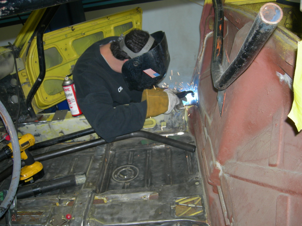

Installing our backing plates.
IPB Image

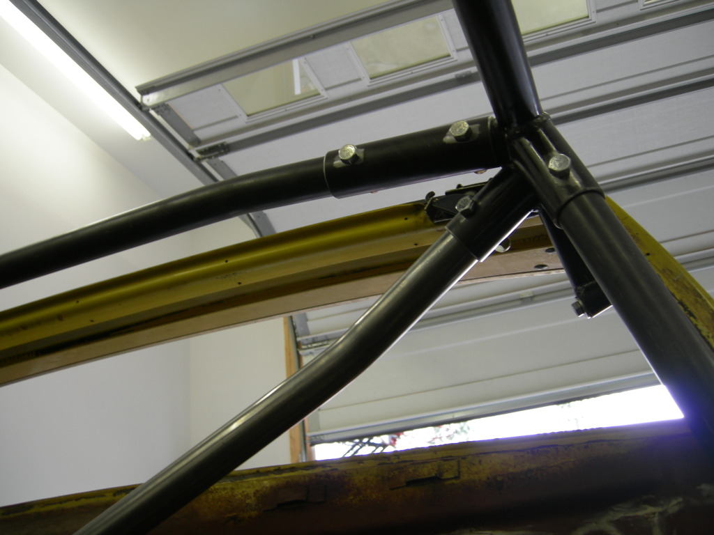

Initial fit up.
IPB Image
IPB Image

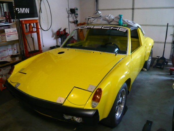

I have two 914 buddies doing this same project...carr914 and Eric Shea on this board. Click this link for some pics of a yellow 914/6 GT
http://www.914world.com/bbs2/index.php?sho...c=42325&hl=
Check out this site for everything you could ever want to know about the 914/6 GT. It is a tremendous online resource. All the best with the build!

Eric_Shea
confused24.gif Do tell what that means. I've never seen a factory cage in a 914-6/GT
My thread should be visable here as soon as they upload the RoadGlue files. Looking forward to watching yours as well:
IPB Image
IPB Image
Keep'em coming.
jhelgesen
QUOTE(Eric_Shea @ Jan 24 2011, 12:09 PM) *
The cage supplied as a sample is reportedly a part of the original factory GT kit....don't hold me to that, just what I was supplied....

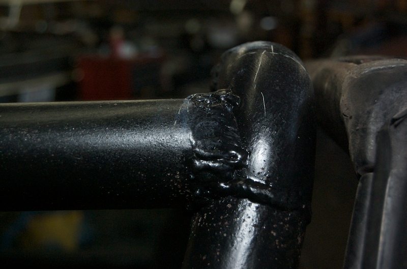

McMark
It's an interesting cage, but I don't think it's factory anything. These welds look as bad as the ones in the german 914/6 I'm working on.

Eric_Shea
There be nothing factory about that cage. There were really never any factory cages in 914-6/GT's. In fact, I believe they even raced without bars the first year. The factory then began to add bars and side bars. Mine (shown here) and the one's Mark is now making are about the extent of the factory efforts on bars/cages. This is modeled off the #40 car:
IPB Image

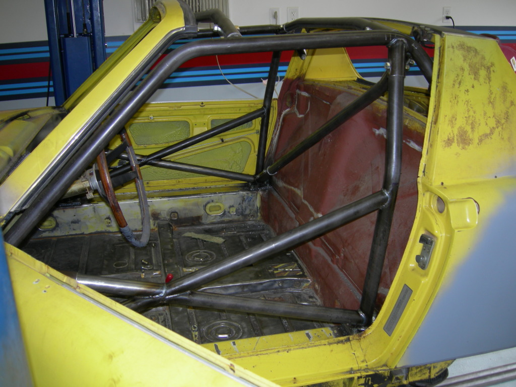

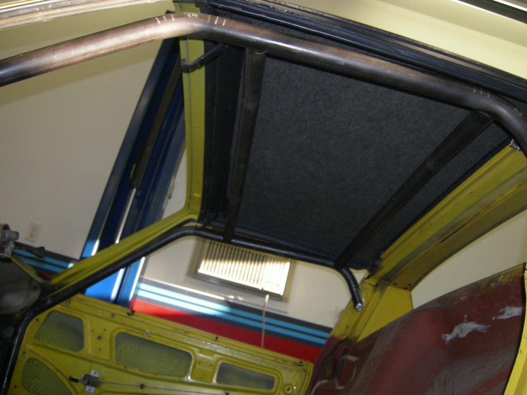

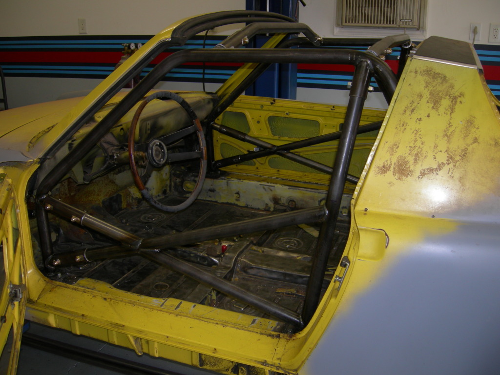

Wrapped up the cage for the customer this weekend. Sleeved and bolted to FIA specs. It's off next for chassis stiffening and such next.
IPB Image
IPB Image
IPB Image
