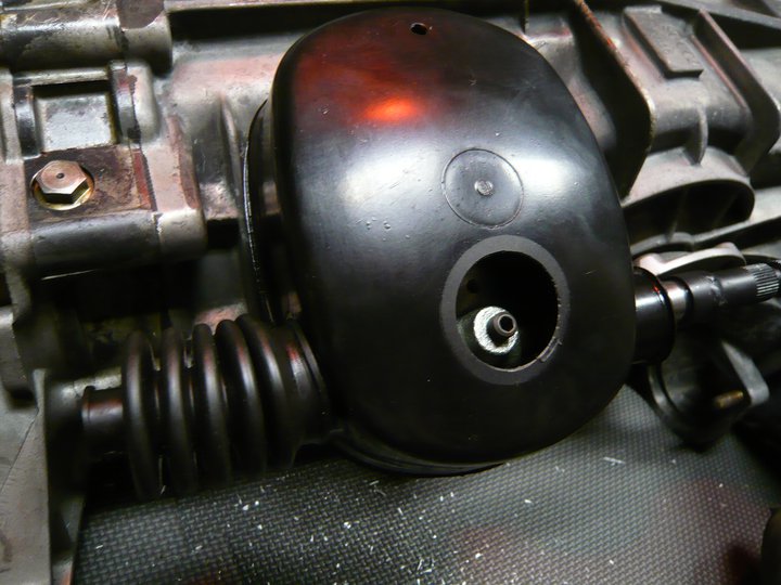

Eric_Shea
I noticed mine (by hand, not installed yet) goes from bushing to bushing here:
IPB Image
When you set it up, did you check the clearances before tightening?
IPB Image

Just make sure that the linkage has some extra room to move when 2nd is engaged. You should not narrow it down to one place to look - you should check the whole system while you are at it since there is not much to it.
Here is a pic (thanks Eric) of the point that must be checked during assembly (both front and rear):
Eric_Shea
agree.gif that's the spot but... wouldn't second be on the back 1/2 not the front where your arrows are? confused24.gif
(thinking, lever forward makes rod go back?)
I indeed had to move that aluminium piece (with the bronze bushings) above to the left by a few mm to allow 2nd gear to full engage. Thanks
