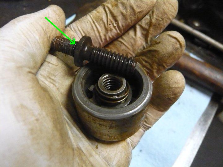

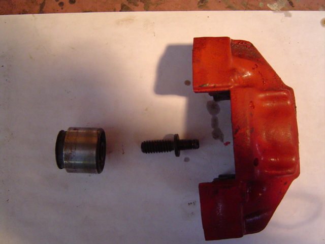

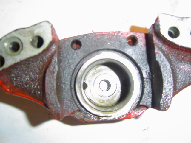

OK, here's some pics of the adjuster screw in question.
There's a boss machined into the caliper body where the flange of the screw goes (2nd picture), but there is not a recess for an o-ring. You could put an o-ring in there but it would simply smash down and be destroyed as soon as you tightened the screw down. I don't see any other sealing method. It's not like the o-ring setup on the inner side of the caliper.

There's an o-ring on that shaft. I can see it from that bad picture dry.gif (Is that a "Big Red?) ohmy.gif
This happens often and when it does, it means you have a hardened, crusty seal. Your seal is old and compressed. It has hardened and will probably come out in pieces. It probably looks almost like part of the shaft at this point. It resides where you see this shiney seal in this picture:
You need to use a dental pick and get that old, bad seal off that shaft. Then, if you have one, it's best to use a 8x1.25 die to chase the threads, Your 13mm nut likes to get hung up on the clip galley:
IPB Image
Once that's done, you need to walk a new seal down the shaft and into the seal galley. Kinda like a "Holla-Hoop" falling to your ankles (or a prom dress). Keep the dental pick in there and walk it down:
IPB Image
Then pop it back in the bore:
IPB Image
If you're "really" a cheapskate (or a cheapsnake), you can try to spray a little PB Blaster on it "WHILE IT IS IN THE CALIPER BODY". If you look at the side of the PB Blaster can you'll see they bill it as a "Seal Reconditioner". It's actually just a petroleum based "Seal Sweller" (which is why you want that seal installed before or very shortly after you spray the PB Blaster on it). Your seal will loosen and swell and should stop leaking (for now). By the time it leaks again, it will be the other owners problem. Then we can start a DAPO thread. biggrin.gif

I just had to know Eric would chime in here and ruin my day. Anyway, I went ahead and cut me a gasket and it seems to have worked, no leak. Despite this small victory, the worst thing about this is the fact that I completely missed the o-ring on the shaft. DOH!
