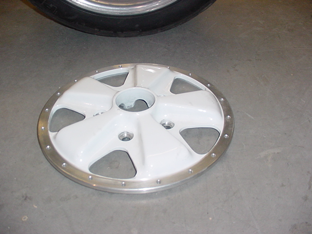

I have 4 of these right now.
I think this is what those companies do with the 6x16 Fuchs.
I am going to refinish and build them as 16's because I have a narrow
body and the race tires I like are in that size.
