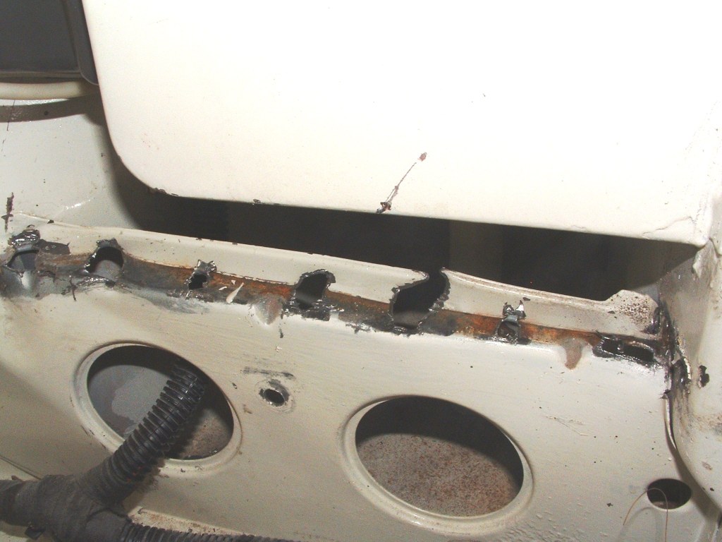

Today I tackled one of the most painful projects to date - tearing out the metal shelf for the front trunk spare cover. It was in the way of where my RX-7 cooler needs to mount so out it came.
It was painful because I could not cut the spot weld below the headlight assembly, so I basicall used an air chisel to rip the metal out.
Here is the shelf with the spot weld cut:
IPB Image

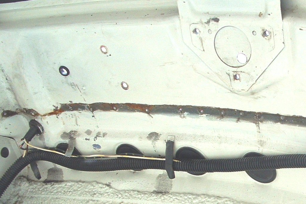

Here is the same area with the shelf removed:
IPB Image
