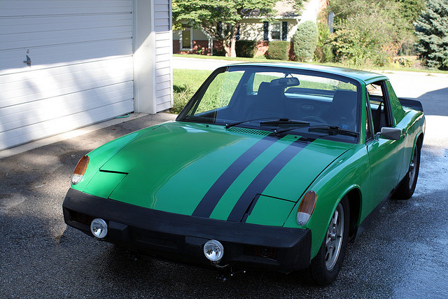

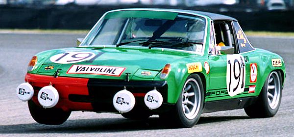

Looking to install some rally lights like the ones pictured. What is the usual size of these and how do they mount? Close up mounting pics would be appreciated.

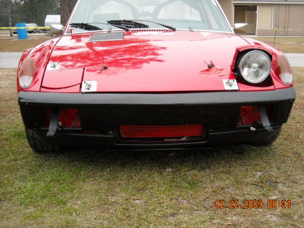

VaccaRabite

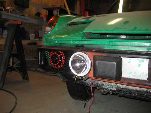

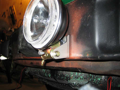

Here is how I did them on my car:
(using Pilot driving lights from Camp 914)
Drilled a hole in the bumper with a nut welded to the back side. I also reversed the mount that Camp sells with the lights and put them on that way. Using this method you do need to fab up a spacer to compensate for the natural curve of the bumper or else your lights look a little wall eyed. I used some aluminum epoxied to the light base. Easy!
IPB Image
IPB Image
Finished:
IPB Image

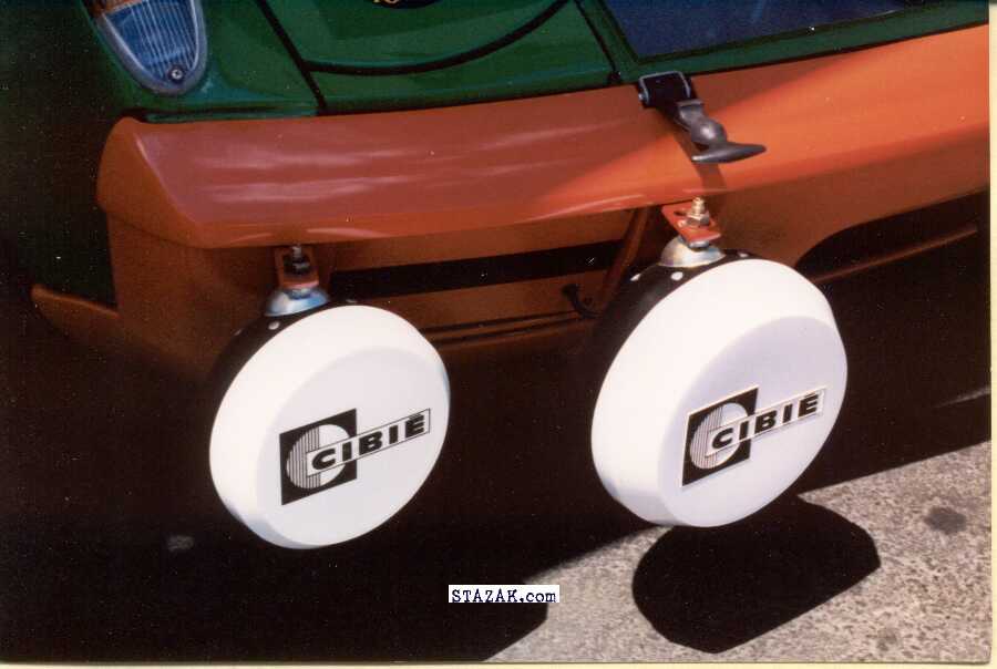

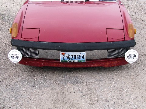

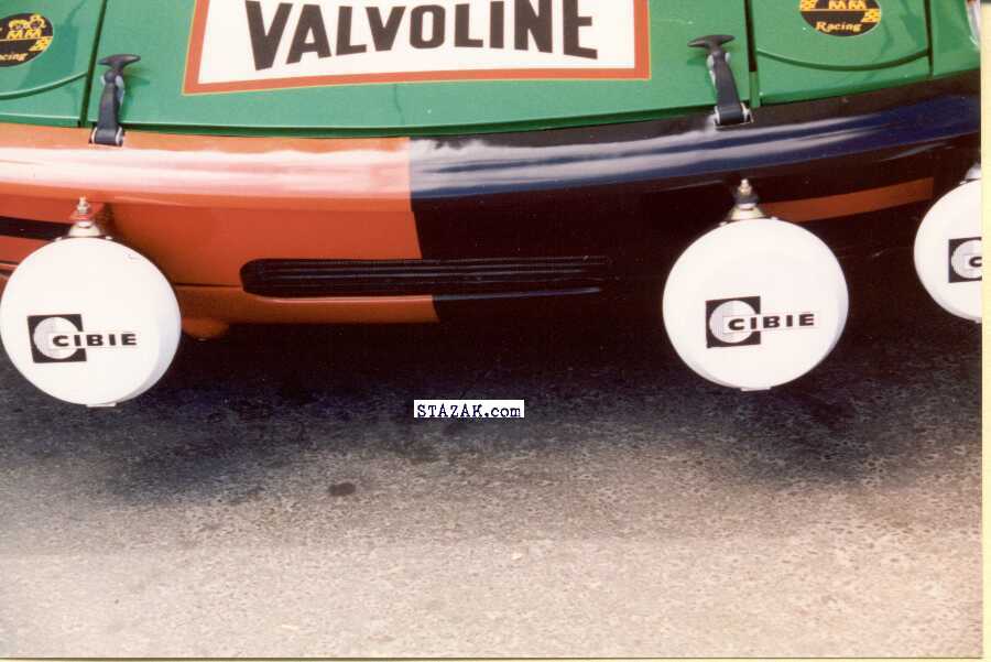

racerbvd

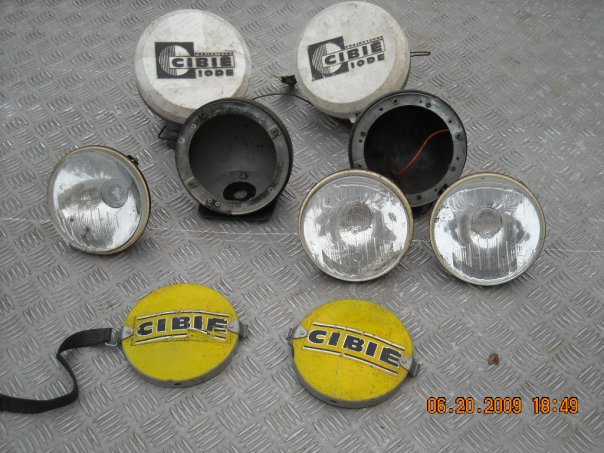

Here are the brackets on a friends real GT.. This is what I want to do for my clone..
These are the lights I am using on my car..
HarveyH
A piece of 1-1/2" angle iron with a long shallow "V" cut in it to clear the lip at the back of the bottom edge of the bumper. 6 or 8 #8 bolts with nuts and lockwashers to secure it to the bumper. Not factory, but inexpensive and sturdy.
