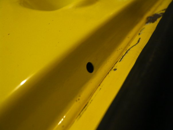

Start with a very clean track. You can see some of the last butyl remnents in this shot. All of that was cleaned out with a heavy solvent:

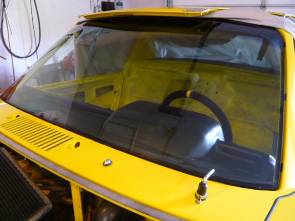

Another tip. Use new clips. I used a 5mm socket to push them in. Makes it much easier and no wasted. broken clips.:

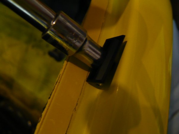

Rubber blocks are under the windshield and you can see the new clips on the side:

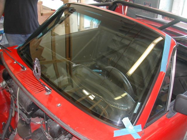

My Windshield install:
http://www.914world.com/bbs2/index.php?s=&...st&p=910188
IPB Image
