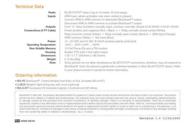

you tell me........ http://www.emxinc.com/blueguard.html confused24.gif

This is just a universal wireless controller, a set of relay contact to control other heavy-duty relays on the machine itself.
Mike Bellis
The output relay is only rated at 2 Amps. It could drive a high power relay for your battery cut off. There are some Ford style relays that are rated for continuous duty.

76-914
I didn't plan on using one at all really. My relay is a barking dog. I was just thinking that people could use on of these "instead of" a battery disconnect. e.g. on the starter, ign switch or fp as already mentioned here.
