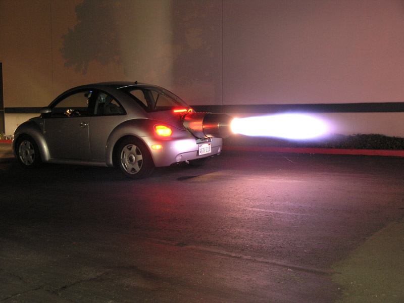

zymurgist
Obligatory:
IPB Image
Jet Beetle
