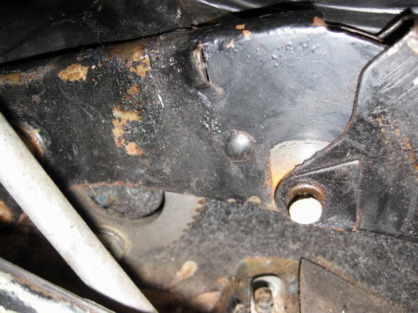

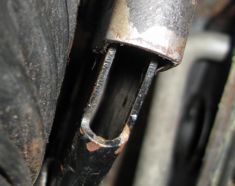

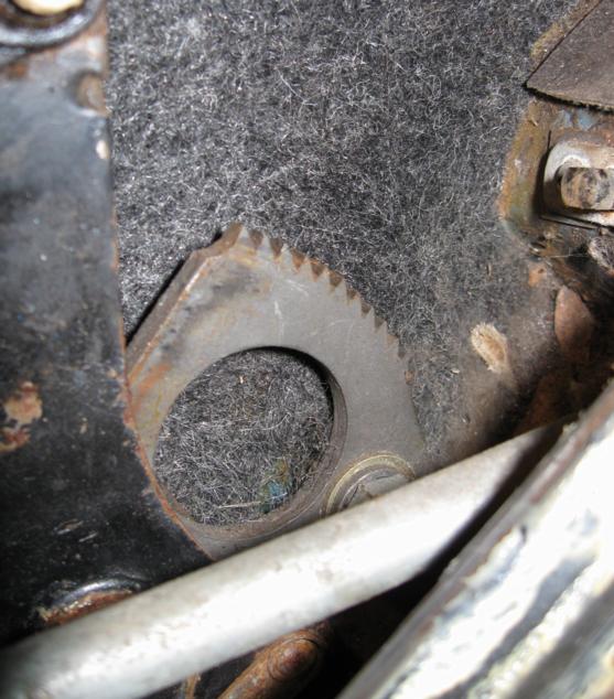

I pulled my seat and took a few pictures. Full up:
full down:
and a shot from the top showing the pawl hiding in there:
I wiggled things around a bit and can get the back piece of the lever to rotate (needs a little grease or wd-40), but the pawl never engages the teeth of the stationary gear. It seems that at some point I (or a DPO) pulled it up too far and completely disengaged the pawl from the gear.
Any ideas from here?
Thx,
S
ScottD914
Oh, that's a good data point. Your cables are way too loose if you can pull the lever up that far with the cables still connected.
Can you push the button in all the way to disengage the pawl and then move the handle down?
(A) If yes, do that, adjust vent clearance, and adjust the locking nuts.
If no, then dis-assemble the e-brake handle, get it working and then goto (A)

What a Rube Goldberg device that thing is! I wound up taking the seat and seat rail out, but eventually got it all put back together and ratcheting. In the process I figured I might as well vacuum under there. Naturally, I sucked up one of the washers and had to dig through my shop vac to find it. Also, the seat is now sitting on the workbench in the basement so I can re-glue the little bit of fabric that connects to the front edge of the seat. (There's always something that needs doing.)
Final adjustment of the parking brake (and I guess I might as well redo/double check the venting clearance) will have to wait for another day. I'm getting too old to be crawling around on my back with the car about five inches from my face...
