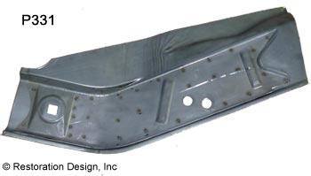

As part of this, I need to replace the metal around the jackpost on the inner wall. I’d like to be able to use this piece from RD:
Can anyone tell me if the RD piece is meant to go inside of the outer long (like the original configuration) or if this is meant to be a single-layer piece, with nothing over it? I'm guessing it's meant to be single, since I think I see a flange on it, and the inner "C" channel pieces don't have that. I’ll have to do some pretty tough fabricating to get the jack post hole right...

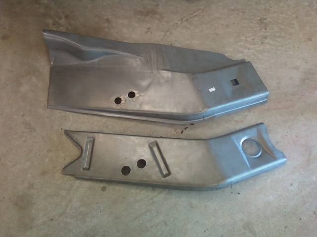

TargaToy
It's meant to be 2-ply.
The smaller part with the round hole in the jackpost area goes inside (behind) the larger part.

Yes! That smaller part in the bottom of your pic is exactly what I'm looking for. But I don't see that on the RD site.
Did you get it elsewhere?
EDIT: I talked to RD. The part I ordered is apparently BOTH parts, with the smaller part already spot welded inside the larger part. Although I'll have to drill out the spot welds, nice to know it's all there. Thanks for the pic.

I ordered the wheelhouse from RD. I had it a little while (still working on the driver's side) and happened to notice on someone else's post that their part had the second ply. When I contacted Mike at RD, he sent me the inner part no charge. I'm presuming that the two pieces are supposed to be one unit and some were shipped as singles (by mistake??).
